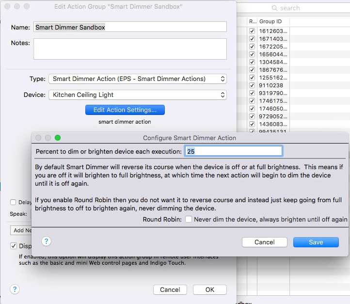

This is only a plugin so no devices are needed. Once installed you will use the plugin "Smart Dimmer" action instead of directly changing the brightness of your device. The action will prompt you for which dimmable device you want to control and the percentage you wish to brighten or dim it.

    • Control Page: Create a button on the control page an instead of setting the action to dim an Indigo device as normal, instead use the EPS - Smart Dimmer and select the device you want to dim and click on the options button to specify the percentage and optionally use round robin. Now each tap of that button will result in brightening to 100% then dimming to 0 back and forth as much as you wish
