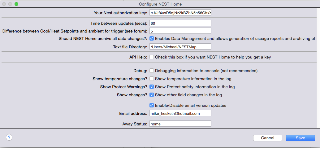

I can see the problem and I think it's easy to fix. But it's better for me to respond in the forum because I can show you a screen dump.
Here's a summary:
There are two things going on and one of them is causing the other. First of all NEST Home can't get access to a file on your machine. It's looking for a directory /Users/NESTdb.track and that doesn't exist. I believe the reason is simple - you need to update your configuration for NEST Home and tell it where to put the tracking text file in a place that it can access and exists
On my system the path to the file is /Users/Michael/NESTMap which points to a folderI created in my user area under /Users/Michael/NESTMap. It's the bit in red that's missing.
So this is what I'd do....
The reason it happened in this case is because every time there was an error accessing the file it accessed the API to try again. Of course that could be many times a second and so Google stopped you. So long as the Configuration Option Time between Updates is set to 60 seconds or greater you shouldn't see this problem in the future.
Thanks for your patience. Give it a go. Let me know what happens...
- Using Finder create a directory under your User area to take the file. Navigate to your area (probably /Users/Martin) and then create a new folder using the file menu (I use NESTMap).
Make sure you can navigate to the new folder
run NEST Home
Select Plugins/NEST Home/Configure... from the menu bar in Indigo
Enter a value in the Text file Directory field to match what you've just created. e.g. /Users/Martin/NESTMap (N.B. don't add a '/' on the end)
Finally click Save and all should work as normal
Regards
Mike
