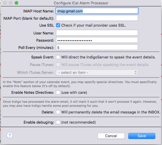

After setting this up as shown (see screenshot; I have redacted the username) I get the following:

I have gone into the account settings, turned off 2-part authentication and turned on "allow less secure apps to access this account". Before I did the latter, I was getting this:
Mar 21, 2016, 9:04:16 PM
  iCal Alarm Processor Error      Unknown error (possibly IMAP server connection error): [ALERT] Please log in via your web browser: https://support.google.com/mail/accounts/answer/78754 (Failure)
What does this mean and what should I do?
