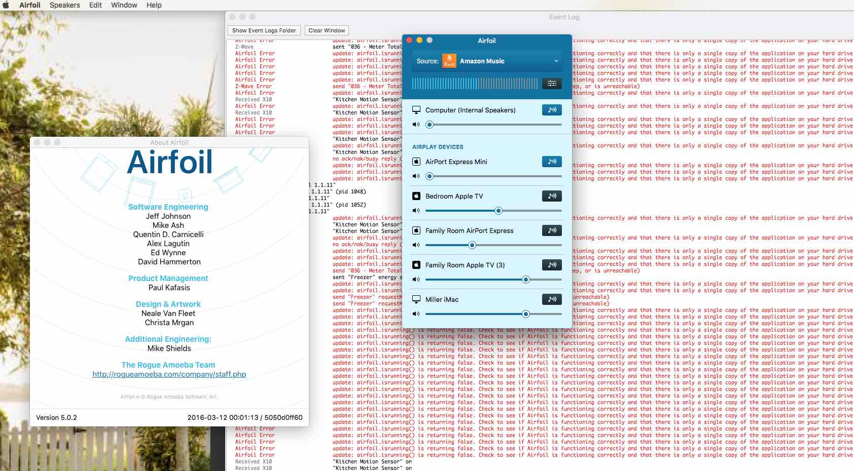

On day 2 of my Trial, I had Airfoil 5.01 installed. it seems to work nicely with the Indigo software.
On day 4 of my testing, I went ahead, and purchased the Indigo software PRO.
Airfoil did an upgrade to 5.02, and I can not longer get Airfoil to work with Indigo. Airfoil alone still works fine.
The log in Indigo states this:
update: airfoil.isrunning() is returning false. Check to see if Airfoil is functioning correctly and that there is only a single copy of the application on your hard drive.
Airfoil Error update: airfoil.isrunning() is returning false. Check to see if Airfoil is functioning correctly and that there is only a single copy of the application on your hard drive.
I uninstalled every folder of Airfoil on my system. I even tried installing Airfoil version 4.92.
Same results. Please let me know how to resolve this.

dz1rfj wrote:On day 2 of my Trial, I had Airfoil 5.01 installed. it seems to work nicely with the Indigo software.
Are you positive when you downloaded the new Airfoil app, you replaced the old one with the new one? It seems quite coincidental that the problem happened right after you upgraded Airfoil. I just confirmed that it's working with 5.0.2 on my system. Did you happen to add any bluetooth speakers?

Yes - Last night,
(in this order)
  • uninstalled Airfoi
    uninstalled Indigo
    re-installed Airfoil
    re-installed Indigo
    Tried the demo database with Airfoil, no luck
    connected back with my Database, no luck
    Airfoil works fine
    Indigo has no airfoil variables
    Ingigo cannot see any airfoil speakers
    Indigo cannot see any airfoil applications
Please see attached PNG file for visual confirmation that these items work , and exist in Airfoil...
I am no MAC expert, and not sure what else to try.
Thanks for the help
Brian

When I checked for multiple copies of Airfoil, and deleted them from where they appeared to have been installed in \downloads,
and after searching several times on THIS MAC, it found only the one version.
Well, while poking around , I found a hidden folder library\applications or \application support, that I would find almost a dozen copies that did not show in the previous searched. Deleted them all...
Problem Solved...
Interestingly, after deleting all copies, and reinstalling , somehow my application remained, which tells me , that somewhere, some remnants of Airfoil configuration was still left behind... The Mac is a bit if a mystery to me in some regards, but after 5+ years of not reinstalling windows, I can't complain at all...
for all non mac experts like myself, and to possibly avoid additional support requests on this, it may be helpful to post a wiki on how to search for all Airfoil copies in the airfoil forum..
Thanks for trying to help me through it
-Brian
