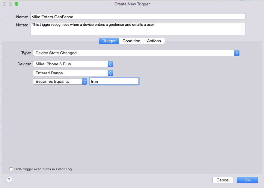

Create a trigger with the following properties:
Name of Trigger: Mike Enters GeoFence
Device: Mikes iPhone 6 Plus
Entered? is equal to true
Trigger properties (device)
Screen Shot 2015-12-01 at 15.45.58.png (57.97 KiB) Viewed 6394 times

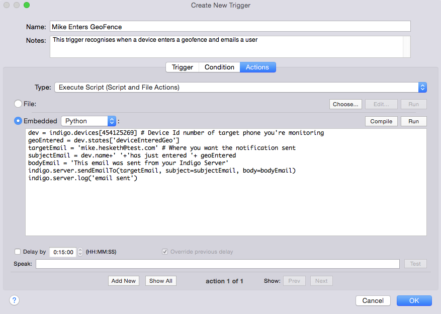

Now we need to create an action for the trigger:
Action: Execute Script (Script & File Actions), Embedded Python
Code: Adjust device Id number to the phone you're monitoring and the email to your address
dev = indigo.devices[454125269] # Device Id number of target phone you're monitoring
geoEntered = dev.states['deviceEnteredGeo']
targetEmail = '[email protected]' # Where you want the notification sent
subjectEmail = dev.name+' '+'has just entered '+ geoEntered
bodyEmail = 'This email was sent from your Indigo Server'
indigo.server.sendEmailTo(targetEmail, subject=subjectEmail, body=bodyEmail)
indigo.server.log('email sent')
You'll end up with this:
Trigger Actions
Trigger Actions
Screen Shot 2015-12-01 at 15.47.50.png (90.56 KiB) Viewed 6394 times
This will send an email with the subject like "Mike's iPhone 6 has just entered Home"

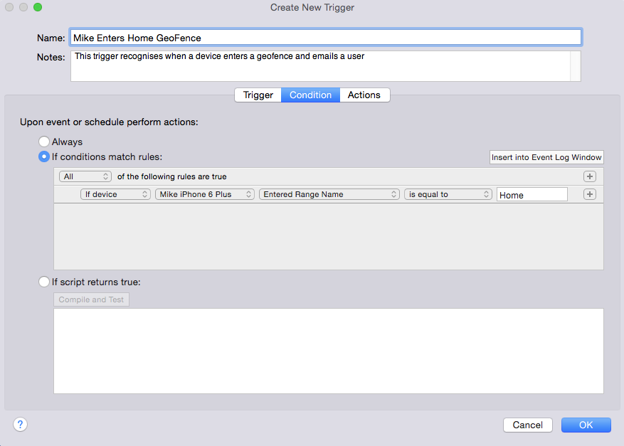

Here's an example:
Trigger Condition (Optional)
Screen Shot 2015-12-01 at 15.49.06.png (62.19 KiB) Viewed 6394 times

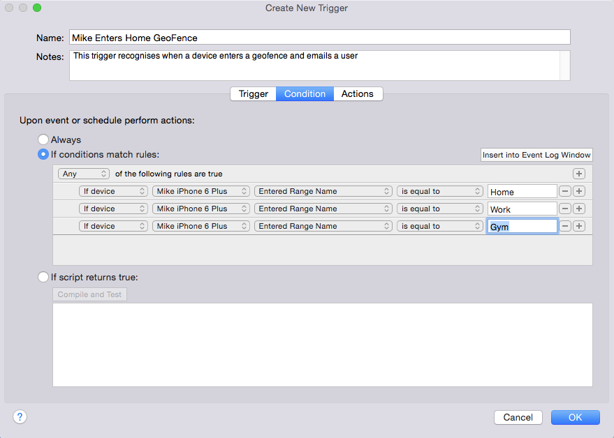

This will only send an email when enter the Home GeoFence and not any other. Of course I could add an Any clause and list a number of GeoFences that I'm tracking e.g. Home, Work, Gym, etc...
Trigger Condition showing multiple GeoFences
Screen Shot 2015-12-01 at 16.00.39.png (76.1 KiB) Viewed 6394 times
