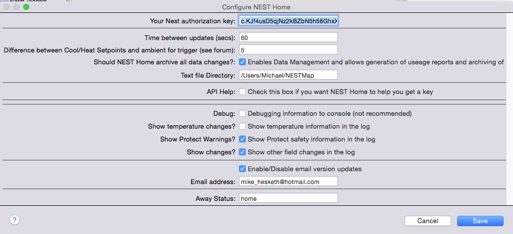

Two new fields have been added to the configuration screen 'Should NEST Home archive data changes?:' and Text File Directory.
Config dialog
Config dialog
Screen Shot 2015-12-06 at 14.35.35.png (105.27 KiB) Viewed 6475 times
You may have already filled in the Text File Directory if you've been using the other NEST Mapping Reports. If so you don't need to change this field. This is where all of your reports and CVS files will be saved for you. If you haven't completed this field yet it's VERY important that you enter a path to a folder you have access to. Check the spelling of the path name, the case and finally don't add a '/' on the end.
You should also ensure that the Should NEST Home archive data changes? box is checked. For some reason you'll find it more reliable if you uncheck and recheck the box before saving! I'll investigate why later.
Once you've updated the fields I recommend that you Save and then Reload the plugin to get data management working straight away. When you do this you'll get a message in the indigo log telling you that ** Data Management Online **
Now you'll be able to use the reporting and export options. Note that nothing will be reported at this stage because none of the NEST States have changed but soon you'll gain a rich resource of NEST information.

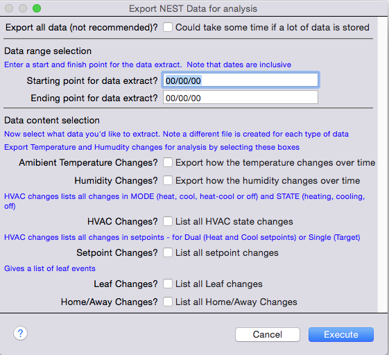

Export to CSV
If you select the Export NEST data to CSV for analysis option from the NEST Home Menu you'll be presented with the following dialog:
Export to CSV
Export to CSV
Screen Shot 2015-12-06 at 14.44.57.png (110.25 KiB) Viewed 6475 times
The first option (Export all data) will get NEST Home to generate reports based on the whole dataset rather than a range. This could take a significant amount of time as your database gets larger and isn't recommended.
The next options allow you to define a date range for the export. The dates are inclusive and must be completed (dd/mm/yy - I'm a Brit so I've kept this format sorry :oops: ) If you want to have a single day, say 4th December, you would enter 04/12/15 for the start date and 04/12/15 as the end date.
Once you've selected your range you can then select the datasets you'd like to export to CSV. Experiment with them to see what's the most useful for you. CSV files can be read in a text editor or imported into most spreadsheets for your analysis.
The filenames will be similar to NEST Report (04-12-15 : 04-12-15) Ambient Temperature.csv
If you look at the indigo log it will tell you exactly where the files are stored and their names

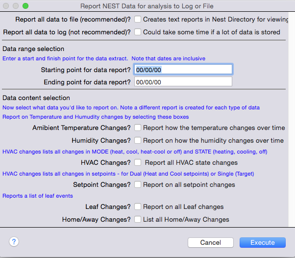

Report to log or file
If you select the Report NEST data to CSV for analysis option from the NEST Home Menu you'll be presented with the following dialog:
Report dialog
Report dialog
Screen Shot 2015-12-06 at 14.55.11.png (122.2 KiB) Viewed 6475 times
The first option (Report all data to file) will get NEST Home to generate reports to text files rather than outputting to the indigo log. It's recommended that text file is the option you select. If left unchecked reports will be displayed in the indigo log
The next option (Report all data to log) will get NEST Home to generate reports on the whole dataset rather than a range. Clearly this could take sometime if there is a lot of data.
The next options allow you to define a date range for the export. The dates are inclusive and must be completed. If you want to have a single day, say 4th December, you would enter 04/12/15 for the start date and 04/12/15 as the end date.
Once you've selected your range you can then select the datasets you'd like to report on. Experiment with them to see what's the most useful for you. There's some basic analysis (hours heating, cooling or off for example) that are generated as part of the files.
The filenames will be similar to NEST Report (04-12-15 : 04-12-15) Ambient Temperature.txt
This functionality is currently classed as Beta and I'm going to add more features in the coming days. However, it would be useful for me to get any reports of issues, bugs or changes so I can improve the software.
