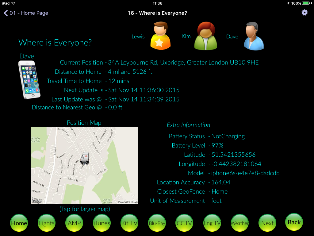

:( :( Hi Mike,
I have a little problem, see screenshot below, I am at home but the "distance and time to" are really out of sync,
What do you think?
Regards,
Dave

TOPS wrote::( :( Hi Mike,
What do you think?
Regards,
Dave
It does look odd but I suspect it's not quite an issue as one's we've had before :)
The plugin looks to see if you've 'moved' in the last period. If you haven't it doesn't call Google for the Distance/Travel Time information to cut down on calls to the API (as we're limited to 2,500/day). I think it's probably an example of the normal update and the real distance update being out of sync. You're right that shouldn't happen so I need to check the real distance against the calculated one and if they're obviously out like yours is it should self correct and then stop accessing the API then while your stationary.
Let me look at it over the weekend.
You may find that a reload will sort the problem. You might also look at the iFindStuff log file to see if there are any errors being generated. Remember to do that BEFORE you reload the software.
BTW - the error log has moved to a more friendly, and obviously place since you last looked.
You'll find the file at:
/Library/Application Support/Perceptive Automation/Indigo 6/Logs/iFindStuffErrors.log
Regards
Mike

Hi Mike,
Thanks for the reply, :shock: I did a restart of IFS and it corrected the calculations.....I possibly jumped in to quick....I think I need to let the Plugin do its thang first, I'll keep an eye on it...
Again,
Dave :roll:
