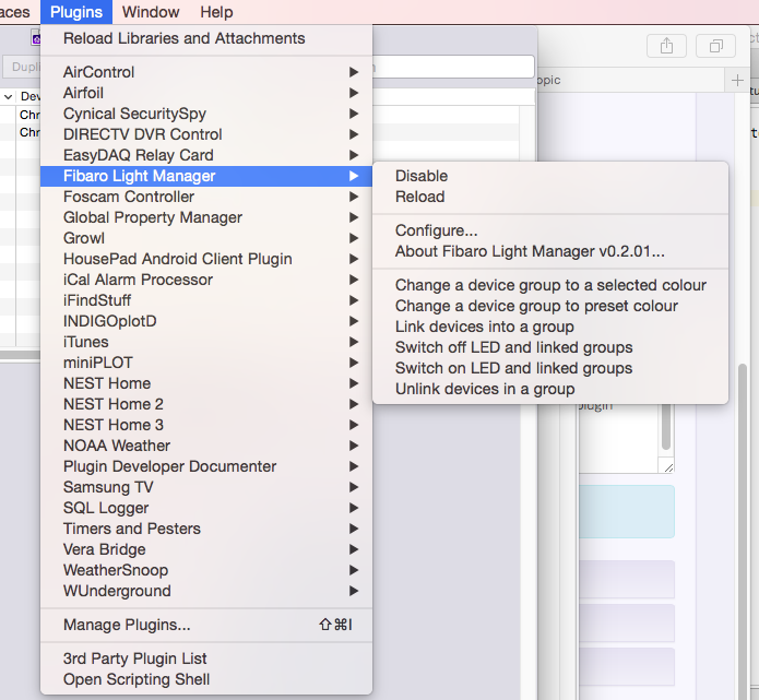

    F02 - Can you add some menu options for setting colours and linking devices. Using actions for everything is tedious. Agreed, so you'll now find there are menu options that mirror the action group options that I provided last time.
    New menu options
    New menu options
    Screen Shot 2015-10-10 at 19.11.15.png (193.46 KiB) Viewed 2877 times
    These options allow you to set up your system initially and then use other action groups to modify how it behaves. I've set my lights so they glow BLUE in the kitchen when it's freezing outside and RED if there is an alarm from one of my sensors.
