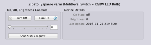

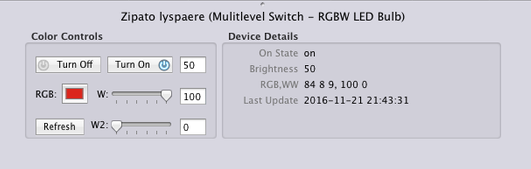

DeltaMike1200
Posts: 11
Joined: Mon Jun 02, 2014 12:47 am
Re: [SOLVED]: ZIPATO - Bulb LED RGBW Z-Wave
Post by DeltaMike1200 »
The fibaro RGBW control in Python script works, I have five of Fibaro rgb units in use and they
sync there colours perfect.
However I want to do the same with the ZIPATO rgb led bulb and sync the colour to the Fibaro rgb led strips.
Do do this I need to set the rgb values from the Zipato bulb according the variables I created.
I cannot locate the Id numbers of the set rgb levels of the Zipato bulb and therefore cannot use them in Python.
DaveL17
Posts: 7323
Location: Chicago, IL, USA
Post by DaveL17 »
Oh, I had it backwards. :D
Perhaps Matt can chime in with the raw commands for the Zipatos.
My Plugins and Scripts
haavarda
Posts: 702
Location: Norway
Post by haavarda »
Assuming that the Zipato uses the same command class as the fibaro, I started to play with the code Matt provided as Dave suggested.
And on my Zipato RGBW bulb the raw command 0x33, 0x05, 0x02, 0x02, 0x64 is working for setting the red bulb to 100 red. The script below should then also work, but I have not tested it yet.
payload = [0x33, 0x05, 0x02, 0x02, 0x64]    # Set red to 100
zwavePlugin = indigo.server.getPlugin("com.perceptiveautomation.indigoplugin.zwave")
zwavePlugin.executeAction("sendRawZwaveCommand", deviceId=dev.id, props={'payload':payload})
Håvard
DeltaMike1200
Posts: 11
Hello Havaarda,
Nice of you to react to the problem.
I've just copied your code into an python action and put the device Id in it.
The code looks like this:
zwavePlugin.executeAction("sendRawZwaveCommand", deviceId=619579665, props={'payload':payload})

I can't seem to make much sense of this light bulb in Indigo 7.
I have two devices that looks like this
Skjermbilde 2016-11-21 kl. 21.45.27.png (43.65 KiB) Viewed 4705 times
Skjermbilde 2016-11-21 kl. 21.46.03.png (38.41 KiB) Viewed 4705 times
The one called "varm" used to be warm color, turning this on now seems to give "cold white" color.
The only way I found to set the color, is to turn both devices off, then set the color in the UI, from the log:
  Z-Wave                          sent "Zipato lyspaere" off
   Z-Wave                          sent "Zipato lyspaere" set color to 84 42 7, -- --
Both devices are then off in Indigo, but the light bulb has color with low brightness. I can then turn on the device "Zipato lyspaere" and the state is updated in Indigo, nothing happens with the light bulb.
From what I understand the top brightness is "general brightness", the middle brightness (W) is "warm white brightness" and the lower one (W2) is "cold white brightness".
Changing the W brightness will reset the colors:
   Z-Wave                          sent "Zipato lyspaere" set color to -- -- --, 100 --
If the light bulb is off, I turn it on and then try to change the color only minor changes to the light happens, but it remains white
   Z-Wave                          sent "Zipato lyspaere" set color to 38 98 4, -- --
   Z-Wave                          sent "Zipato lyspaere" set color to 42 98 52, -- --
   Z-Wave                          sent "Zipato lyspaere" set color to 7 98 74, -- --
   Z-Wave                          sent "Zipato lyspaere" set color to 25 79 98, -- --
   Z-Wave                          sent "Zipato lyspaere" set color to 98 55 74, -- --
   Z-Wave                          sent "Zipato lyspaere" set color to 98 58 27, -- --
   Z-Wave                          sent "Zipato lyspaere" set color to 56 98 14, -- --
   Z-Wave                          sent "Zipato lyspaere" set color to 35 98 16, -- --
   Z-Wave                          sent "Zipato lyspaere" set color to 9 13 98, -- --
I also have some trouble finding a reliable way to set colors and back to warm white with actions.
There is probably something I'm missing here, so some tips would be appreciated :)
