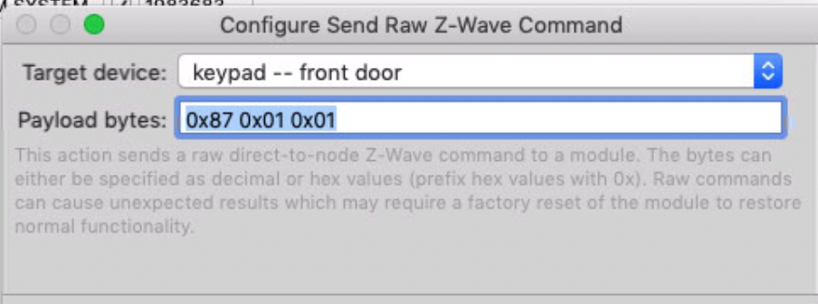

Jay thanks so much for your work. I have been building my own PIN using a 0 second timeout receiving each number press separately. I suspected it would work as you determined and it has been on my ToDo list for a couple of years to experiment and figure out what you have learned. Now I don't have to do it ... thanks to you. :)
To execute the built in indications use the raw command ... screenshot attached of typical command. Also list of payloads for each command below.
[*] 0x87 0x01 0x01 speaks "home and armed" and HOME button lights up red
[*] 0x87 0x01 0x02 speaks "away and armed" and AWAY button lights up red
[*] 0x87 0x01 0x03 speaks "disarmed" and DISARM button lights up blue
[*]0x87 0x01 0x04 turns on the siren and the RING flashes red
[*]0x87 0x01 0x05 speaks "sensors require bypass" and flashes the checkmark white and turns on the yellow warning light
[*]0x87 0x01 0x06 makes a heartbeat noise and the ring flashes red in a CCW motion
[*]0x87 0x01 0x07 makes a heartbeat noise and the ring flashes red in a CW motion
[*]0x87 0x01 0x08 makes a chime noise and the ring flashes red
That's as much as I figured out through my experimentation.
