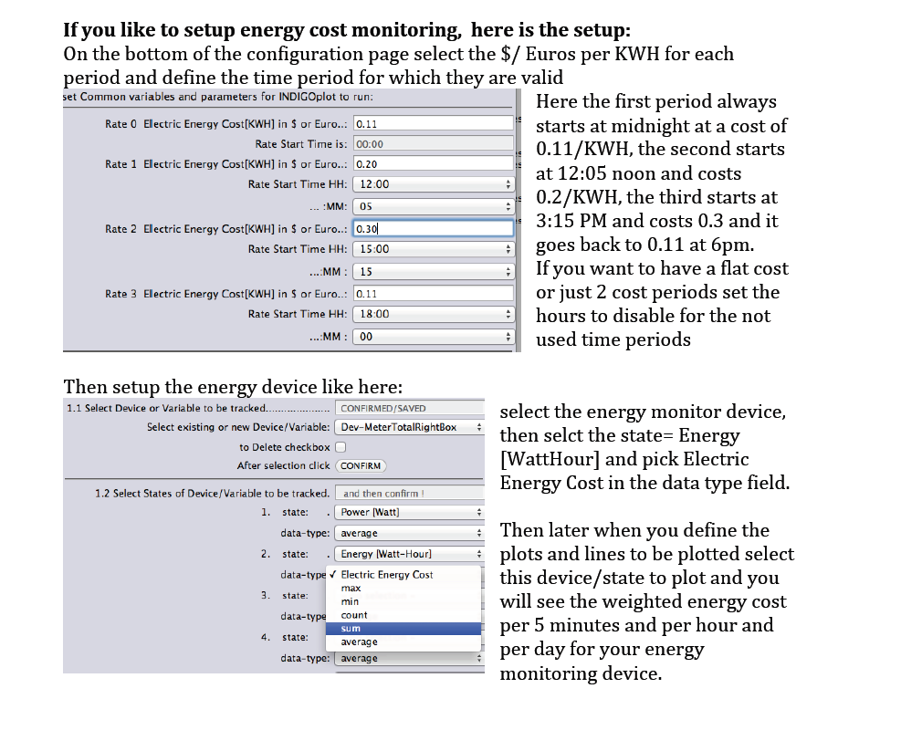

https://www.dropbox.com/s/36zjj9y8wg51l ... -2-7-1.zip version 2.7.1
fixes:
smaller clean-up, i.e. delete test files etc.
added:
electric energy monitoring functionality. See attached image on hoe to use it.
fixes:
added:
- Screen Shot 2014-05-18 at 11.53.11 PM.png (185.63 KiB) Viewed 20878 times

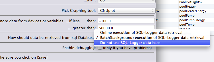

1. do you have sql logger enabled?
2. could you switch to "Do not use SQL-Logger" in Configuration at the bottom of the page, see attached screen shot.
3. and if you are on OSX 10.9 could you try using matplot?
indigoplot to indigoplotD does not transfer any data, should be no interference, 2 completely independent plugins.
Once its running, could you go into the test plot and see if there are any lines defined.
