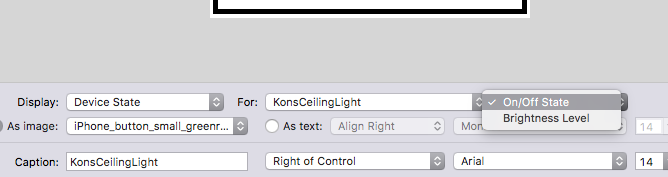

when setting up an iTouch page there is not option to show
"dev.lastChanged"
only "device.states["xxx"] are available, where xxx are the regular and custom states, no access to property "lastChanged"
it would be nice to be able to show dev.lastChanged on the page with the value of e.g. sensor data (temp, rain,...)
"dev.lastChanged"

I believe we have that on the request list, but I'll make sure it's there.kw123 wrote:when setting up an iTouch page there is not option to show
"dev.lastChanged"
it would be nice to be able to show dev.lastChanged on the page with the value of e.g. sensor data (temp, rain,...)l
FYI, a much better place to put this type of request would be in the Plugin SDK forum rather than on one of your topics.

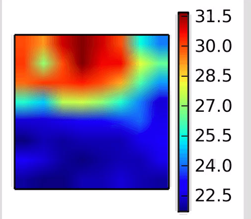

coming up:
IR camera (AMG88x33 ) images, triggers .. images available in the plugin
- Screen Shot 2018-01-25 at 20.33.36.png (170.3 KiB) Viewed 3381 times
