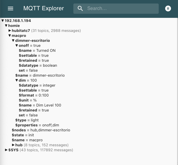

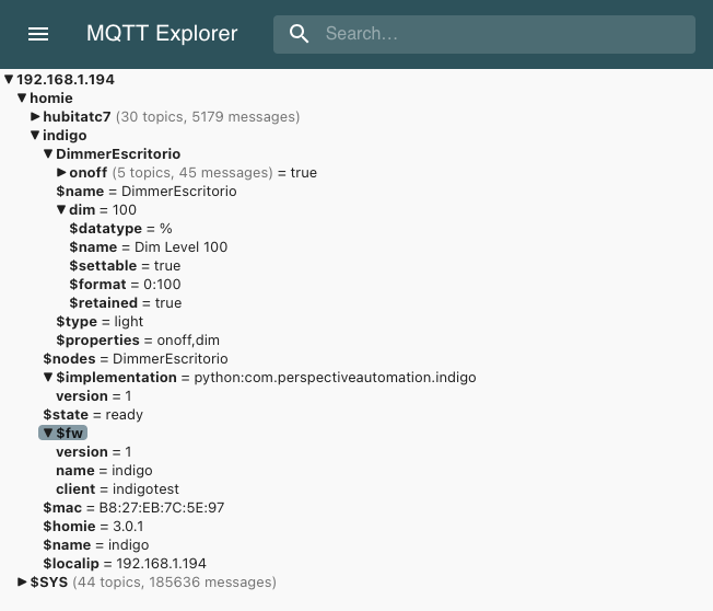

The screen capture below shows the contents of my single device attempts. It's a z-wave Honeywell z3005 dimmer, which I named "DimmerEscritorio" for my tests.
I tried to mimic info from post 2 and a few below by another user trying to achieve the same thing, which was answered by the xAPPO/MQTT author saying the schema looked good... But it still doesn't work on my case.
PS: Before anyone ask, I have no idea what to put in $implementation, so I just tried something similar to what the author of post 2 did in his case.... (I'm mostly in trial and error mode now, remember?)

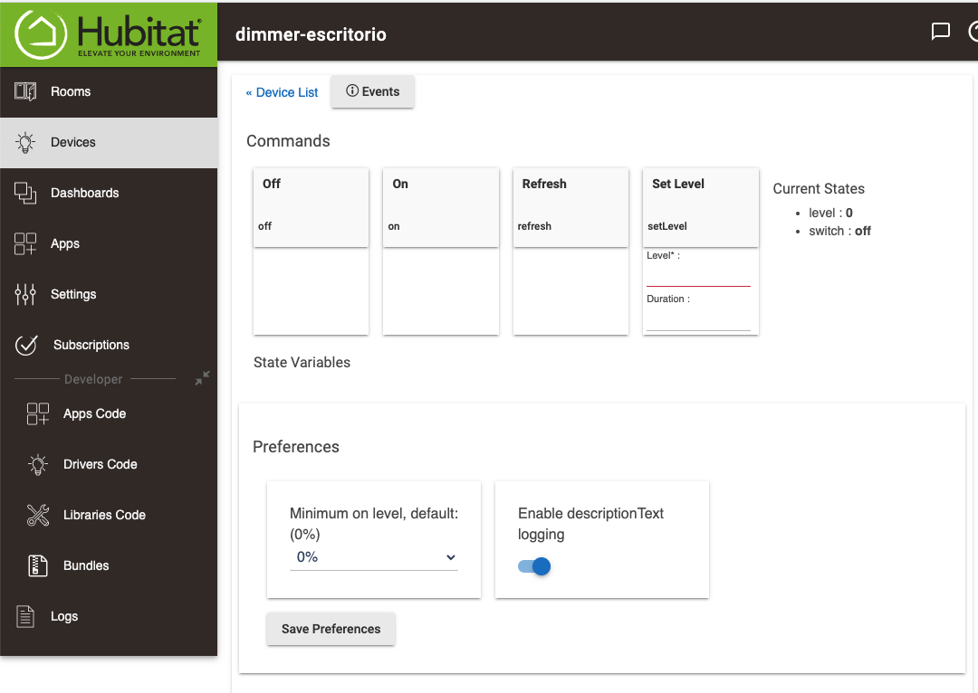

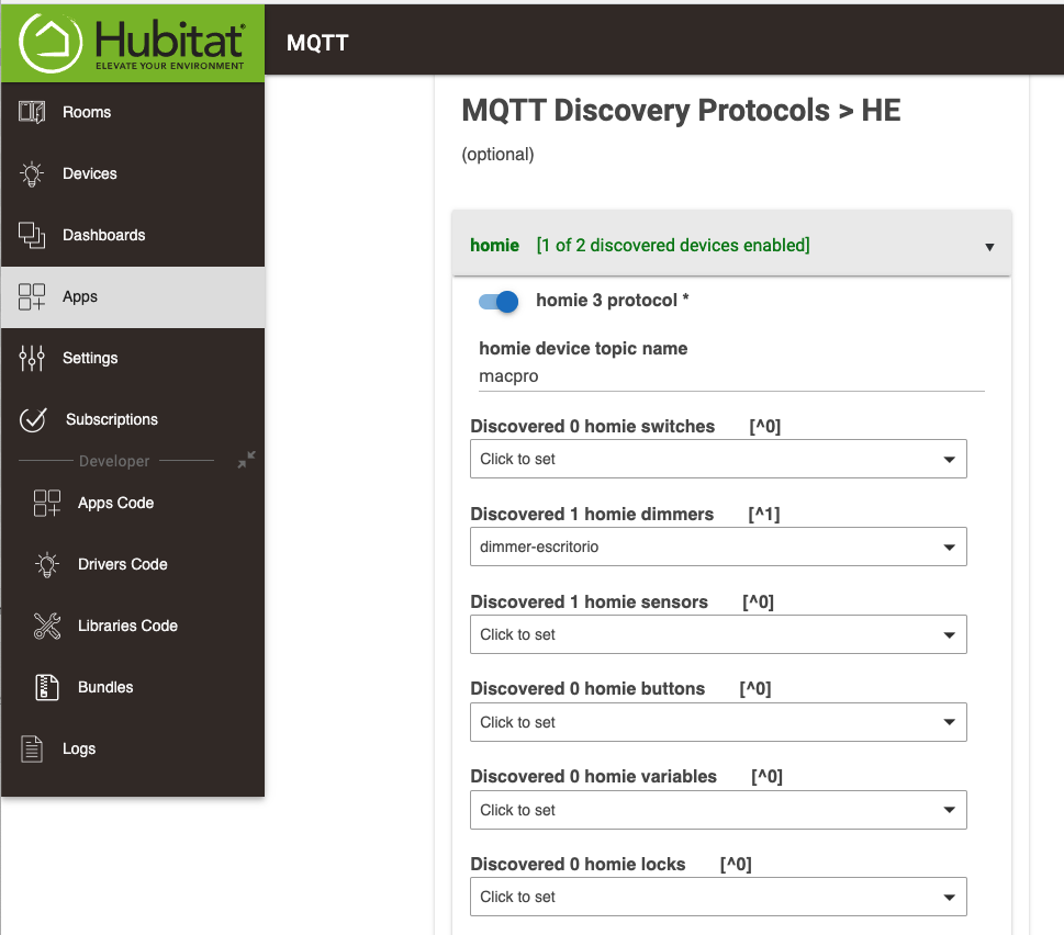

Good Morning and Good News!!!
Trial and error proved helpful.

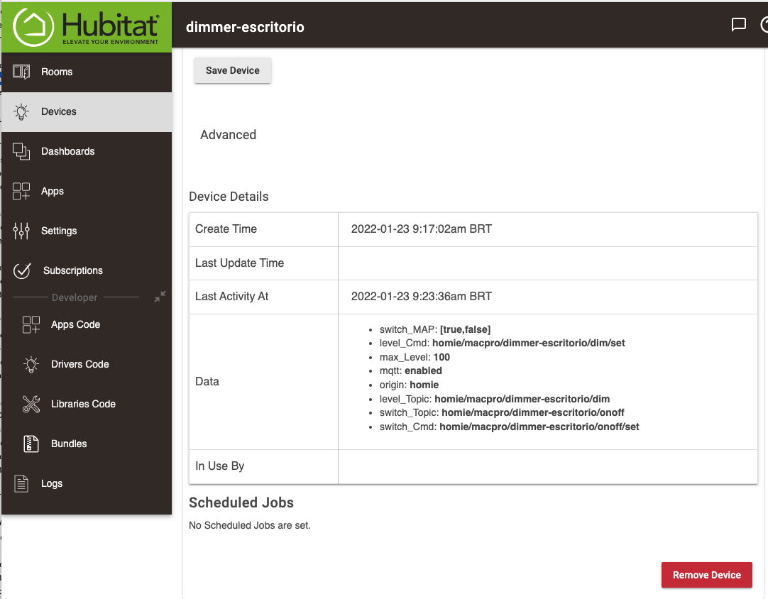

I have now found out why the Indigo MQTT published device was not being matched by the xAPPO/MQTT App Discovery Into HE. It's most likely a bug I intend to report to Kevin (the author) after I clear out the last issue I'm facing.

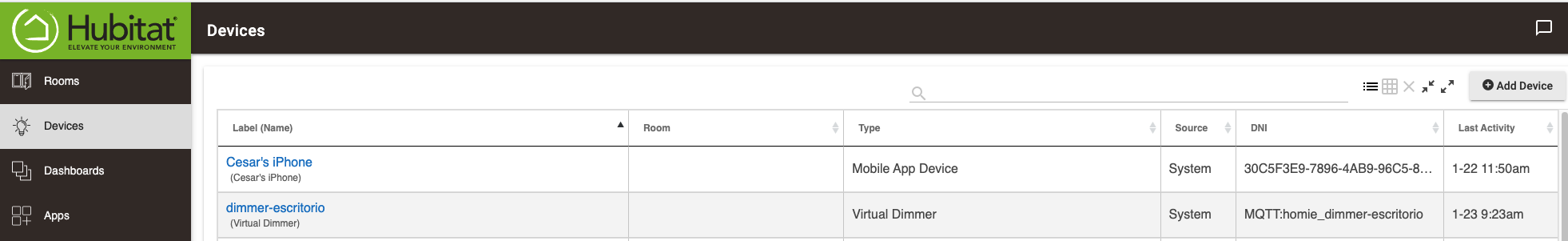

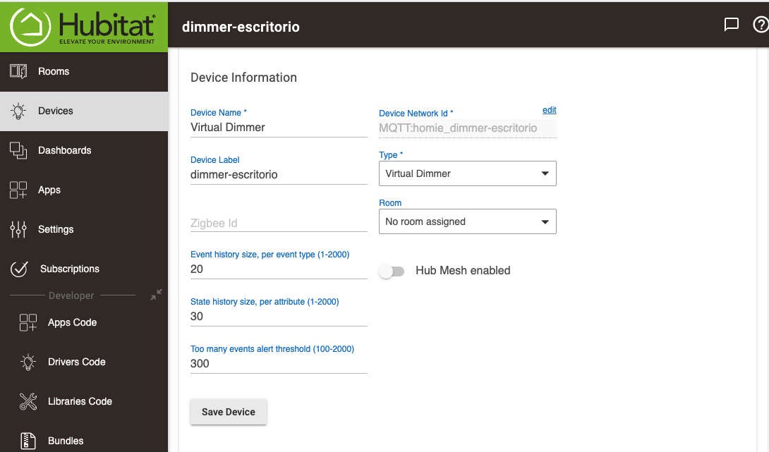

The xAPPO/MQTT App and driver now **automatically** create a virtual device in Hubitat Elevation, so I'm sure I can put to rest my previous doubts wether it would even be capable of doing what I intend it to do. The following screen grabs show my current status.
But not everything is roses yet: Even though the xAPPO/MQTT App and Driver now catch the Indigo MQTT published device, it still cannot control it, that is, I cannot turn the discovered dimmer on/off, nor set it's brightnessLevel from the HE side be reflected on Indigo. The other way around it works as expected, meaning that I can turn on/off, set the brightnessLevel from Indigo and it correctly shows on the Virtual Device properties pages as well as on HE Dashboard.
It's probably something I need to change in the topic structure, but I don't intend to loose my Sunday on it, as Yesterday was a real marathon trying to make this thing work.
Now that I'm on the right track, I'm going to spend most of the day enjoying my swimming pool as it's Summer here and the sky is clear.
Screen grab from Hubitat Elevation MQTT App: Screen grab from MQTT Explorer, depicting the topic structure as published by Joe's Indigo MQTT plugin: Screen grab from HE devices, showing the virtual device auto-created by xAPPO/MQTT App and Driver below the iPhone device previously existing in HE: Screen grab from HE devices, showing the virtual device auto-created by xAPPO/MQTT App and Driver (1 of 3): Screen grab from HE devices, showing the virtual device auto-created by xAPPO/MQTT App and Driver (2 of 3): Screen grab from HE devices, showing the virtual device auto-created by xAPPO/MQTT App and Driver (3 of 3):

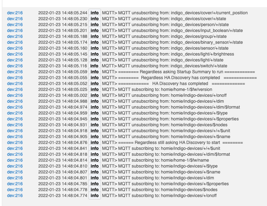

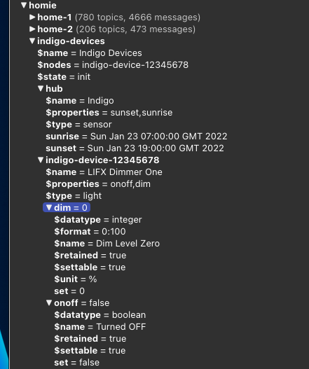

I have copied your MQTT Explorer definitions but I must be doing something wrong as my device still isn't discovered.
Here are my definitions: This is the result of doing Run homie discovery now: I notice in your MQTT Explorer definitions that you set for the dim a value = false as opposed to an integer. Could that be causing your set problem?
Once I have got the correct format to work then I should be able to fairly easily modify my plugin to publish Indigo devices to be discovered by this process.

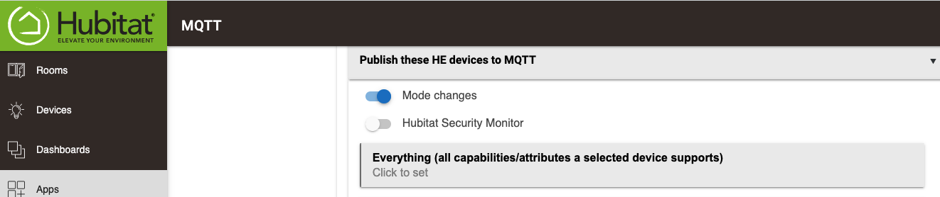

If you set anything on the following EVERYTHING (all capabilities....) button, please unset it and set individually in each particular device type buttons below it.
My integration only started working AFTER, on a hunch, I decided to remove everything from it. I think it's a bug that somehow reflects on the other side of the integration, as my understanding is that this section would only refer to SENDING HE devices, but there must be some shared code, I believe.

Hi Ceasr,
At your convenience and after your swimming
, could you post an image of your MQTT Child filtered Event log for when you do a discovery, just so I can see if it is similar or I have missed something. Thanks.
If I can get this to work, then I think that in my plugin, it would be a small matter to define a new Hubitat device type and set up a the edit device configuration to select theIndigo devices to be published to Hubitat so that they can be discovered and then updated when states change. That would avoid having to setup loads of triggers.
