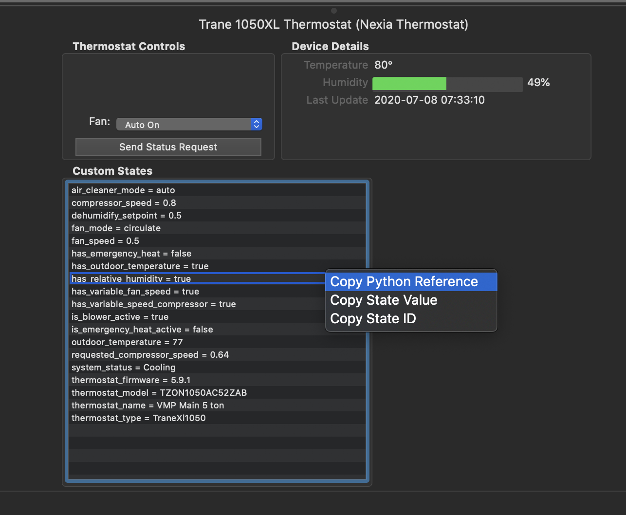

With some devices, I can look at the home window for that device and scroll down to see all the different states and they are written in pytonese(sp?). onOffState , onTime, etc. Like for a Running Timer device.jay (support) wrote:Say more?
For some devices, they are harder for me to find.... Example; my insteon thermostat. When I was writing a python script to tell me a device state from my thermostat, I made a thermostat device on a control page, then looked at the 22 different states you can choose from to use as a baseline for the verbiage I needed for my python script.
Is this the part where you tell me about the super simple button you click on somewhere that lists all of a devices states in a python reference format?

Re: Timed Devices plugin
You mean this list?whmoorejr wrote:Is this the part where you tell me about the super simple button you click on somewhere that lists all of a devices states in a python reference format?

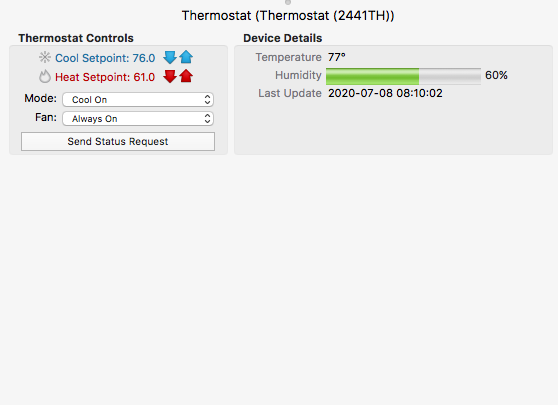

I didn't know you could right-click on that stuff to get the python reference..... but how do you get the python references for states when certain devices don't show custom states? My thermostat shows the controls, but no custom state block below it. Same thing with lights, fans, motion sensors.... without going through everything, it looks like the stuff that works directly without a plugin.FlyingDiver wrote:You mean this list?
The devices that work via plugin typically have that "Custom States" box.
- Insteon Thermostat.png (35.04 KiB) Viewed 9776 times
