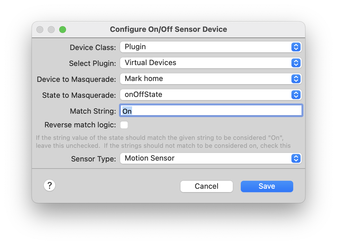

Hi. I have a virtual device called 'Mark home' which gets switched on and off via HomeKit according to whether I am home or not. I want to use it in Occupatum so have set up a Masquerade device to make it show as a motion sensor. But nothing happens...
Am mystified... I've tried leaving the match string empty and tried including it. I manually switch on and off the source device, but the masquerade device does nothing at all.
What am I doing wrong?

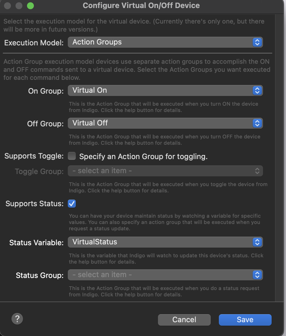

The onOffState of a virtual device is only usable when you have "Supports Status" checked, AND your on/off action groups set the status variable's value appropriately.

And then use "True" as the match string, since the state is actually a boolean.
Londonmark
Posts: 571
Re: Masquerade Plugin
Post by Londonmark »
That works - thanks. Was literally the next thing I was going to try but then though better to ask. Will be braver next time...

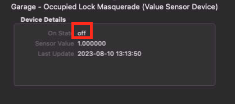

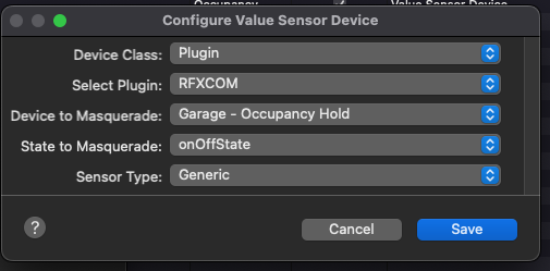

Howdy! I'm trying to use Masquerade to publish an on/off relay to Occupatum. I can get the Masquerade plugin to update its state from 0 to 1 depending on the on/off state of the device, but the Occupatum device doesn't follow its changes. Now I think it's because in the device details the On State isn't updating, but I can't find any way to get it to update, nor am I 100% sure that this is what would mark that room as occupied in Occupatum.
Here's the device output:
10 Aug 2023 at 13:26:14
   Script                          address :
allowOnStateChange : False
allowSensorValueChange : False
batteryLevel : None
buttonGroupCount : 0
configured : True
description :
deviceTypeId : masqValueSensor
displayStateId : sensorValue
displayStateImageSel : NoImage
displayStateValRaw : 1.0
displayStateValUi : 1.000000
enabled : True
energyAccumBaseTime : None
energyAccumTimeDelta : None
energyAccumTotal : None
energyCurLevel : None
errorState :
folderId : 231565974
     com.flyingdiver.indigoplugin.masquerade : (dict)
          SupportsOnState : true (bool)
          SupportsSensorValue : true (bool)
          SupportsStatusRequest : false (bool)
          baseDevice : 1209817393 (string)
          deviceClass : plugin (string)
          devicePlugin : nl.rjdekok.indigoplugin.RFXCOM (string)
          masqSensorSubtype : Generic (string)
          masqState : onOffState (string)
          matchString :  (string)
          reverse : false (bool)
lastChanged : 2023-08-10 13:13:50
lastSuccessfulComm : 2023-08-10 13:13:50
model : Value Sensor Device
name : Garage - Occupied Lock Masquerade
onState : False
ownerProps : com.flyingdiver.indigoplugin.masquerade : (dict)
pluginId : com.flyingdiver.indigoplugin.masquerade
protocol : Plugin
remoteDisplay : True
sensorValue : 1.0
states : States : (dict)
     sensorValue : 1.000000 (real)
subModel :
subType :
supportsAllOff : False
supportsOnState : True
supportsSensorValue : True
supportsStatusRequest : False
version : None
Here's the print out of the device itself (although I have tried it with other on/off devices too)
10 Aug 2023 at 13:46:27
   Script                          address : 000000
batteryLevel : None
buttonConfiguredCount : 0
configured : True
description :
deviceTypeId : EMW100Appliance
displayStateId : onOffState
displayStateImageSel : PowerOn
displayStateValRaw : True
displayStateValUi : on
enabled : True
errorState :
     nl.rjdekok.indigoplugin.RFXCOM : (dict)
          address : 000000 (string)
          unit : 1 (string)
ledStates : []
model : EMW100 Appliance
name : Garage - Occupancy Hold
onState : True
ownerProps : nl.rjdekok.indigoplugin.RFXCOM : (dict)
     unit : 1 (string)
pluginId : nl.rjdekok.indigoplugin.RFXCOM
protocol : Plugin
     onOffState : on (on/off bool)
subModel :
subType :
supportsStatusRequest : True
version : None
I've attached a couple of screenshots of the states and config in case they help. Also I've tried it with different device types (such as a z-wave relay) but with the same results. I suspect I've just not got something configured correctly, but I'm drawing a blank on what that is. Any ideas?
