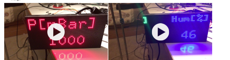

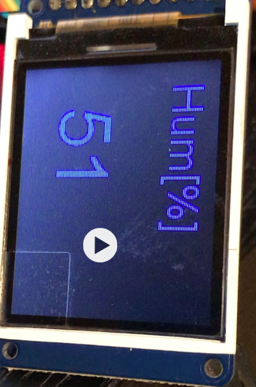

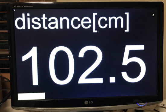

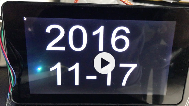

posted v 7-31-29
added:
- additional check for files getting to large. Eg if your connection is bad the rejects file might continue to grow and then the FTP might fail which will prevent the rejects file from being reset..
- added support for any display / monitor that attaches to the HDMI output. In the devices edit you select one of these monitor/display types
The pibeacon can display any local sensor (temp,humidity,pressure, luminance, dynamic ultrasound measured distance linear or log scaled) or any sensor from another RPI or any text/line/circle,/histogram, png-files/device states static/ rolling up/ down/ left/ right/ through an action group
added:
- ssd1306 128x64 (i2c)
- sh1106 128x64 (i2c)
- ssd1351 RGB 128x128 (SPI)
- st7735 RGB 160x128 (SPI) (example shown)
- RGB matrix 32x32 (adafruit LED display)
- RGB matrix 64x16
- RGB matrix 64x32(example shown)
- RGB matrix 96x32
- large screen connected to HDMI or direct connect (example shown 7 inch original RPI display 800x480) or SunFounder 7" IPS Display (example shown1024x800) or any regular monitor(example shown: 1600x1200)

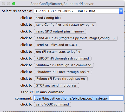

posted v 7-33-33
fixed:
bunch of smaller things, menus, formatting etc
added:
you can now send your own unix commands to each RPI: egwould restart all pibeacon py programs
it can be launched from the menu or as an action.
added build-in commands in are "forced" shutdown and reboot options (not shutdown but sync;halt and sync;reboot -f) through socket communication in the menu in addition to the regular ssh communication. It might come handy when an RPi hangs.. instead of power a cycle.
fixed:
added:
sudo /usr/bin/python /home/pi/pibeacon/master.py
also the short form works:
sudo python master.pyit can be launched from the menu or as an action.

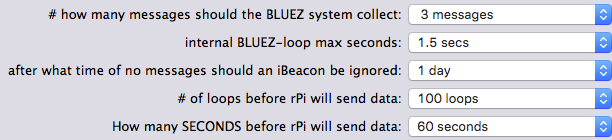

posted v 7-35-34
added:
- should recognize the new TILES devices (tested with the slim wallet tile)
- tuned bluetooth data acquisition to be quicker to respond and include more types of bluetooth messages - not just "pure" iBeacon signals
suggest you change your config settings: strongly suggest Not to decrease the "How many seconds ..." and "# of loops before rPi will send data"
I tried with 30- secs and 20 loops with 15 Rpi and ~ 30+ beacons indigo was busy receiving the data and updating sqllogger..
The RPI programs will send new beacons or reappearing beacons anyway immediately.
- tuned some parameters at startup of the RPI to not send time info (needs to get the new timestamp from the NTP server first) and to collect data for 40 seconds before sending data for the first transmission
added:
