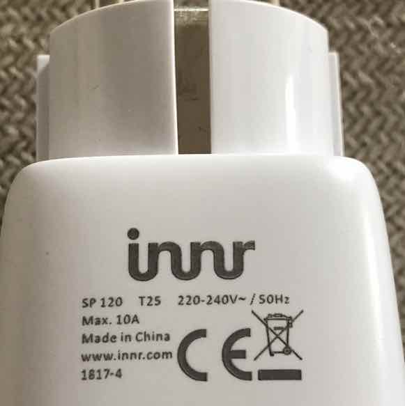

Hi nsheldon,
Thanks for your answer. The INNR Smart Plug shows up as a On/Off plug: the model is empty but sw says 20.
On the PowerPlug itself it says:
SP120 T25
And lastly. www.innr.com
1817-4
It seems that I am not able to attach pictures as they always get to big.
It is super if you can ad it.
Thanks in advance.
Regards, Jacob

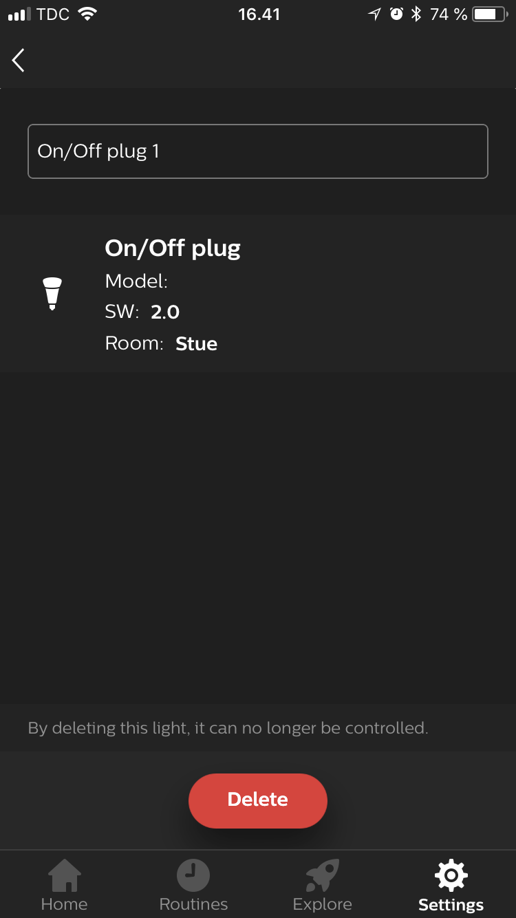

Re: Hue Lights discussion
Here is a picture of the HUE App where INNR is:
Hmm. The Hue Lights plugin requires a model ID in order to know what kinds of messages to send to it. Maybe you could get some debug logs that I can look through to see if I can find an ID to use. Enable debug logging by going to the Plugins menu then Hue Lights then Toggle Debug Logging then reload the plugin (Plugins -> Hue Lights -> Reload). Paste the entire log from the reload.
Version 1.6.13 Posted
- Added support for the Innr SP 120 On/Off Plugin module.
- Added support for the IKEA 30x90 color temperature LED panel.
