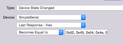

I have just noticed that the trigger from last Hex command is not working even when i copy the received code from the log. It does when when i use “has any change” but when you use “last response hex” becomes equal to” i get no trigger. This will be handy to update a variable.

Below is what my Trigger main page looks like for a hexadecimal state change "Becomes Equal to." Unfortunately, you can’t see the whole text field without scrolling within it. When creating a Trigger, be careful not to include any spaces before or after, and no quotes in the text field for comparison.
I expect you realize this, but just to be sure, note that if you copy from the log, and then enter a command that responds back with the same value, it won’t trigger for “Becomes Equal to" as the value hasn’t changed. You have to force a different value, and then resend the command that gives the response that will initiate the trigger.
Jim
