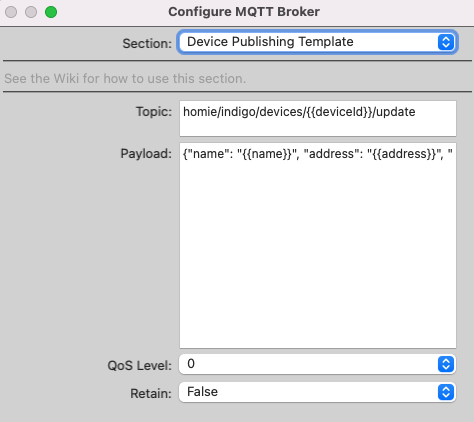

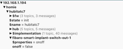

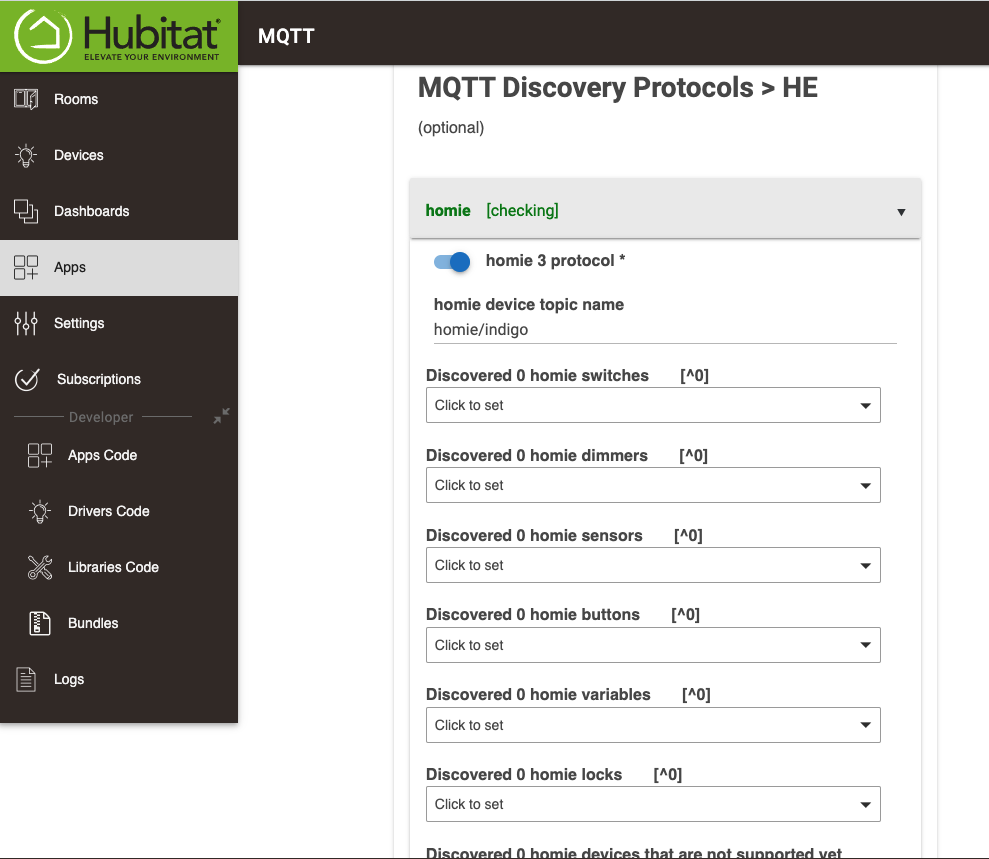

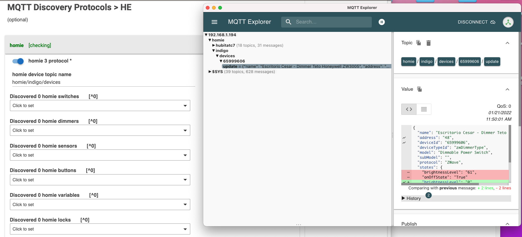

Hi Jon,
I got the "from HE device to Indigo" part working, after a few hiccups, but now that I want to try the other way around "from Indigo device to HE", it seems my two working neurons are not enough...
I suppose it's something I have done wrong (or failed altogether to do) in HE MQTT app and it's not really something related to your plugin or Indigo, but I was hoping you could point me to an article or post somewhere, because I searched and found the HE MQTT app and driver documentation lacking and confusing (must be my two working neurons...).
The third image below shows how I configured the HE MQTT app > HE and the contents of the topic in MQTT Explorer. I can't seem to make the dropdowns in the "MQTT Discovery Protocols > HE" to be populated with device data.
UPDATE: On second thoughts, maybe IT IS something I have to do in Indigo. Do I have to change the MQTT Publishing Template in Joe's (aka FlyingDiver) Indigo MQTT Connector Plugin Broker to match the way HE MQTT app/driver publishes HE originated devices, so that it follows some obscure standard? I mean, do I have to follow some particular schema? If so, where can I find a description?
Please see second attachment below for and example of how one of my HE originated devices (fibaro smart implant) was published and you'll notice that it is completely different from the way Joe's standard MQTT Publishing Template in the MQTT Connector Broker (first attachment) does the same thing. Am I on the right track?
UPDATE2: I think I may have found it. Starting to read https://homieiot.github.io/ NOW!!!

Re: Hubitat Plugin Beta
Hopefully before you disappear too far down the MQTT rabbit hole, you dont need the MQTT plugin at all for the Hubitat plugin. The plugin gives you 2 way communication out of the box once you create the device with the HE plugin, however you do need the HE MQTT plugin set up correctly, but as its publishing then you look like you should be good.cesarvog wrote:Hi Jon,
I was also hoping that would be true, but nothing appears on the dropdowns of HE MQTT app for me to select devices "learnt" from Indigo, which seems strange.autolog wrote: You shouldn't need to do anything with MQTT EXplorer or Joe's MQTT plugin.
No it doesn't.autolog wrote: Just turning the Indigo device on and off should work.
I presume it doesn't?
I'm not sure I follow, I thought I only need to define devices in the Indigo Hubitat Plugin for those devices "learnt' from HE into Indigo. Not the other way around, which is what I'm trying to accomplish now, so I can use zwave devices from my current z-wave mesh in Indigo. I think the terminology here is playing a part in our conversation, because it's all MQTT here, MQTT there, plugin here, app there, driver there. Please excuse me if it's not clear. English is also not my 1st language.autolog wrote: What sort of device have you defined it as in the Indigo Hubitat plugin?

- In the C-7, added a Fibaro FGS-222 Smart Implant (z-wave device) that provides TWO instances of out relays and configured it so that I could turn those relays on and off individually, by using the Hubitat Dashboard feature. Tested and both work as expected from the Dashboard in my computer, as well as from the Hubitat iPhone App. No delay whatsoever in turning those on and off.
- In Indigo 2021.2, installed your plugin into Indigo and created a MQTT Bridge of model Hubitat Elevation Hub (MQTT client) device, pointing to the same Mosquitto instance mentioned above.
- In Indigo 2021.2, created two MQTT Bridge devices of type Outlet (socket), pointing to the Fibaro Smart Implant FGS-222 above, which magically appeared as available devices once I selected the Hubitat Hub Bridge from the device creation Indigo interface.
- Tested switching on/off both Indigo devices created above from the Indigo devices list, by pressing the Turn On and Turn Off buttons. The devices responded immediately and the correspondent devices in Hubitat Dashboard turned yellow when ON and black when OFF. Tested switching the same devices from Hubitat's Dashboard and found out that the devices in Indigo where also switched, instantly. So I thought the whole setup was working as expected. So far, so good!
At this point I posted my Thank you message to you in this forum as I was happy with the results so far, I then went to bed, planning to try "the other way around" the next morning.
That's where I am now. Your solution works perfectly for HE devices to appear and be controlled by Indigo. I'm willing to also find a way to do the opposite: control Indigo devices from HE Dashboard. I don't know what type of device I will have to define in HE, but I've read somewhere that it supports virtual devices. Hope this clarifies.
My best guess is that, in order for me to be able to define devices in HE that somehow point to Indigo devices, the following section of Hubitat's MQTT app interface will have to somehow populate the series of dropdowns shown in this image:

Hello Jon and CliveS,
Jon, not willing to derail your plans, but... have you seen sections d) and e) of the following link?
https://github.com/xAPPO/MQTT
In there the author of the xAPPO/MQTT App and Driver for Hubitat Elevation provides some info on **automatic** discovery of devices (therefore, not needing virtual devices) in his App.
Like I said before, I found some of the documentation available for the MQTT App and Driver kind of lacking/confusing, but I thought I should give you this pointer, as my understanding is that there are two methods for automatic discovery of "foreign" devices into HE:
a) one is to import devices from Homie and/or OpenHAB, by using something called the Homie3 protocol.
b) the other is to import devices from HomeAssistant, by using another thing called the statestream protocol.
I had no idea neither of those existed before I first learnt about the xAPPO/MQTT App and driver.
What I'm trying to do using Joe's MQTT Connector is using triggers that add MQTT data that tries to follow the Homie schema, so the automatic discovery already built on xAPPO/MQTT App will go on and populate the dropdowns existing on the section of MQTT App depicted on my previous screen grab. From there, I figure I should choose the devices I want the App to create. At least this is what I figure is possible. If I can't make it work using the Homie schema until tomorrow, starting Monday I will try the same thing using the HomeAssistant schema.
So, if you still have not seen section d) and e) from above linked github, maybe you could and see if your understanding is the same as mine.
Your last post here seem to indicate you are thinking of doing something more in line with what is explained in section f) of the above linked github.
Best regards and many, many thanks for all your help.

Interesting, I think you are correct and that would avoid setting up a virtual device in HE.
Have you managed to get Homie or Home Assistant discovery to work?
