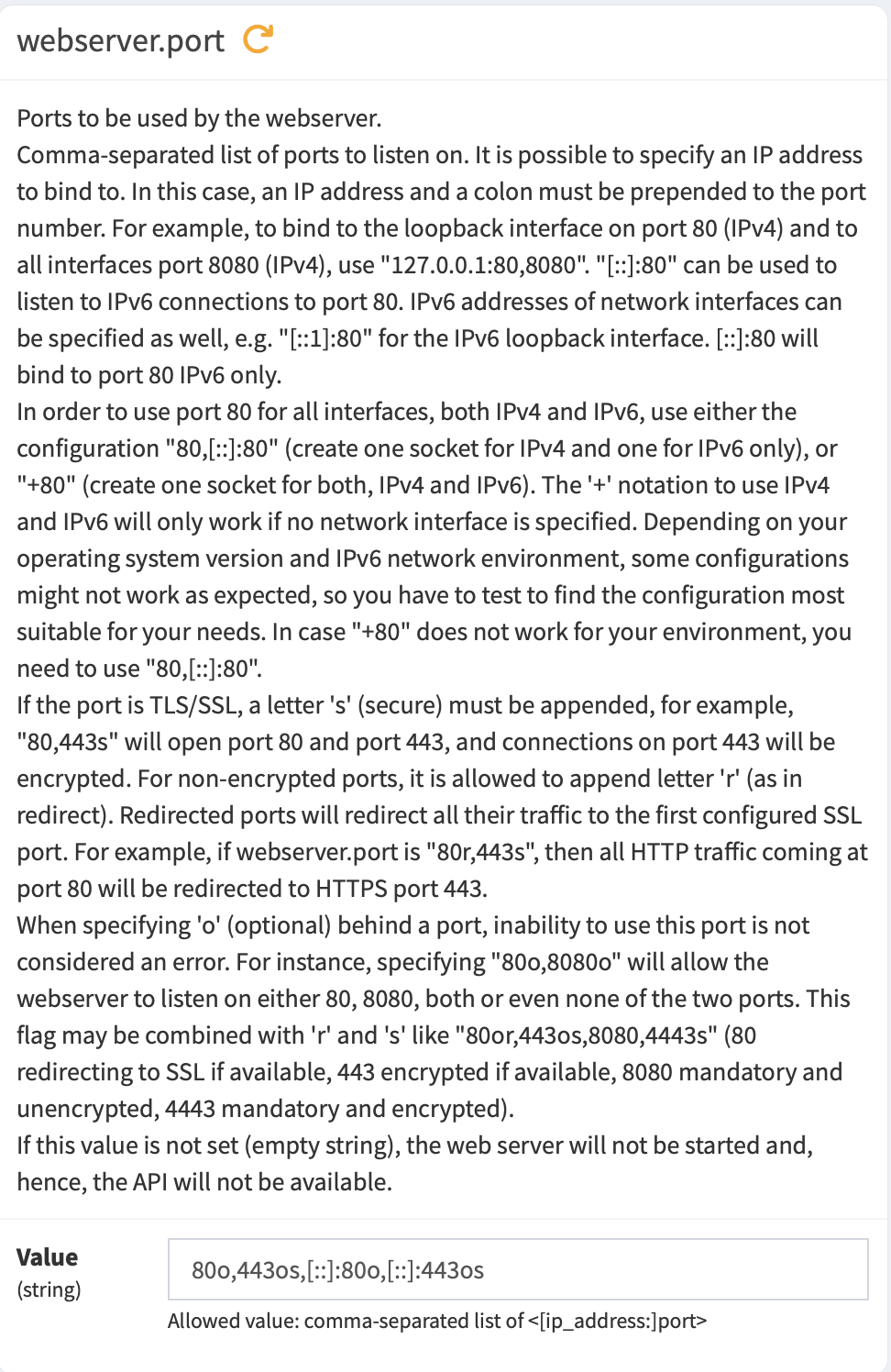

First there were 2 things I needed to do in the PiHole config:
1. Change the webserver.port value (see screenshot)
Settings > All Settings > Toggle Expert in upper right > Webserver and API > webserver.port > change from 8080 to 80

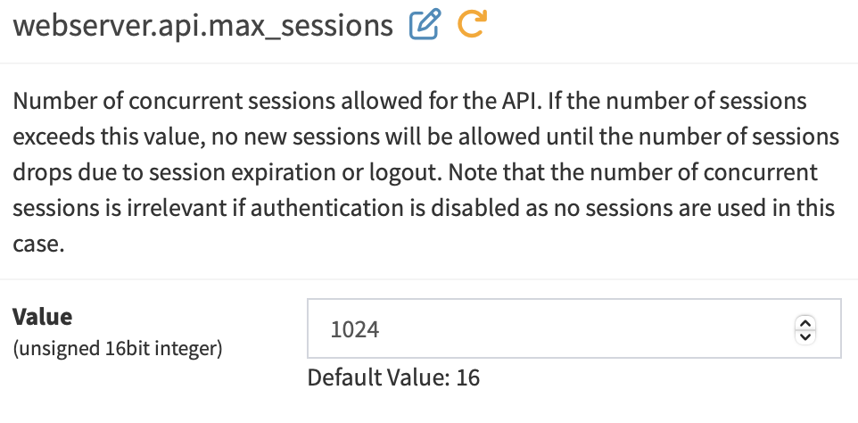

2. Change the timeout for webserver.api.max_sessions (see screenshot)
Settings > All Settings > Toggle Expert in upper right > Webserver and API > webserver.api.max_sessions > change from 16 a higher number (I used 1024)
