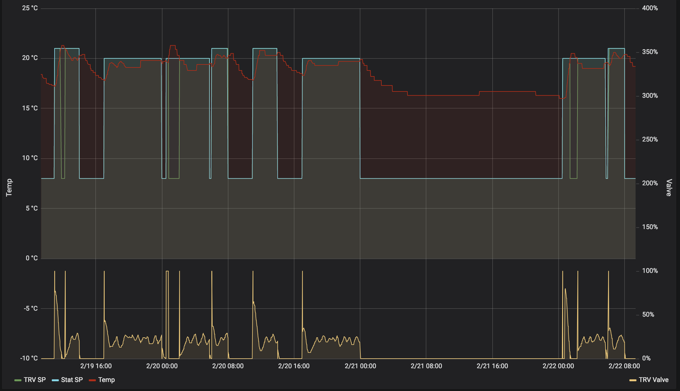

Another example where 4 Set Point changes were missed in a row, at 00:05, 7am, 11am and 7pm and then strangely it kicked in again at the next 00:05 schedule. I now have a trigger to warn my if the room drops below 17, which I was planning to use to trigger a boost in the hope the TRV would pick that up, but would the plugin then instruct it to go back to the current scheduled set point after the boost runs out?
Another TRV did the same thing but missed morning and evening schedules since Tuesday evening, and started responding this morning. In the meantime, all other TRVs are working as expected. This TRV is at 50% battery, the one above is at 20%.
On topic of batteries, I have already replaced one set, have you tried any testing to see if turning off valve reporting helps battery life at all?
Simon

With regard to the missing setpoint changes and using boost - the plugin should revert to the correct schedule.
What was the actual Spirit device setpoint showing during this problem period?
I could add a TRV Controller device option to disable Valve Reporting? I'll add it to the list of things to look at. :)

It's the green line. Both the TRV and what I call the thermostat, IE the plugin device, were at 8 degrees the whole time.

siclark wrote:It's the green line. Both the TRV and what I call the thermostat, IE the plugin device, were at 8 degrees the whole time.
Looking at the graph (and from what I can make out) the green line isn't on 8 the whole time?
It goes down to 8 when the temperature exceeds the setpoint or am I missing something? :?

Yes, the green line does drop to 8 a few times when the actual temp > setpoint. Thats not the problem.
If you see at 2/20 00:00 it comes on then at 20, then up to 22 at 7am. Comes on again at 22 at 11am for 2 hours, then at 5pm at 20 until midnight.
For 24 hours from 2/21 00:00 nothing happens. The plugin device does not set the setpoint for any of those 4 times, ie the pale blue line doesnt move, and the TRV valve doesnt turn on . The TRV is responding as we can see the temperature reports.

OK - I understand :)
Looks like something went wrong when the plugin reset the daily timers which it does at 15 minutes past midnight. :(
Are there any error messages in the log around that time on either the 20th or 21st?

I have emailed you the logs for 3 days. On the 21st it looks like only 2 of the devices were restarted, and then the log is very quiet, as they were not reporting schedule changes.

As I suspected, there was a problem with the schedule re-statement.
The log shows a number of errors of the form:
error='ServerCommunicationError -- timeout waiting for response'
The plugin is asking Indigo for devices and it takes too long to respond.
In the normal Indigo log, are there any errors around 5 minutes to 20 minutes past midnight. :?:
Indigo seems to be having some difficulty responding in a timely manner. :|
I will have to think about how to double check the schedule restatement is successful and how to recover if not. :)
