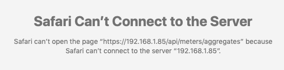

OK, so you need to have an actual brain to do this stuff?
, However same result. Might I need a port number?

Typically you connect to the Gateway. Can’t imagine that they would remove gateway web option.
Might need to connect to the gateways wifi connection (always on annoyingly) Named TEG-2GT.
Then go to the default IP address.
https://192.168.91.1/
Check Network tab and see if you wifi connection listed.

My network is TEG-H3Z. I guess that represents the 3rd generation? It asks for a password. My Tesla account pw doesn't work. The installer gave me a 10 character pw which didn't work. Somewhere I remember something saying the default pw is the last 4 digits of the serial number. While the first two pw tries brought back wrong password messages, the last 4 digits of the sn never came back with a message it just gives me a twirling wheel.

Talk about having to be spoon fed, geese louise . . . I have no idea what the password is that the installer gave me because it does not match what was inside my gateway 2. Also didn't match the sticker on the bottom of the case which wasn't easy to get a picture of so I could read it . . .
I'm in peak time at the moment so I need the battery running so I can't shut it down right now but I did finally get on. Will this plug in only work if the gateway is running off of Wifi? The Tesla access point that's plugged into the router is at 192.168.1.85 which I've never been able to connect to. I don't see a place in the configuration for a password only the IP address.

The gateway needs to be connected to your wifi network - then the plugin can connect to it, and you can acccess via local IP if needed.
See the video in the prior link, starting 2:08 - updating network, wifi bit.
Won’t shut it down by updating the network.
Not sure what you mean by Tesla AP? Perhaps that is solar aspect ?- that is unrelated to this. The plugin just needs the gateway info.
You will need to setup network as video, and give the Gateway a static IP for plugin to use.
