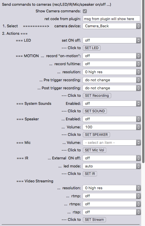

posted v7.23.130
supports (most) functions needed to set cameras IR, mic, speaker, LEDs on/off/; streaming low/med high res for the unifi cameras.
Also supports now debian (besides ubuntu) ops sys for the NVR
Tthe following functions are available in menu as well as in actions: You need to enter in config the video - web userid /password as well as the unix userid/password.
It then creates a NVR type device in indigo with states: and one camera type device for each camera .
It gets the apiKeys of the NVR web page as well as the apiKeys for each camera through mongo db reads / web reads on the NVR on the unix box.If you change the apiKeys, it will refresh them.

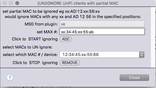

released v 7.26.149
added menu item to ignore partially defined MACnumbers. eg : Karl
