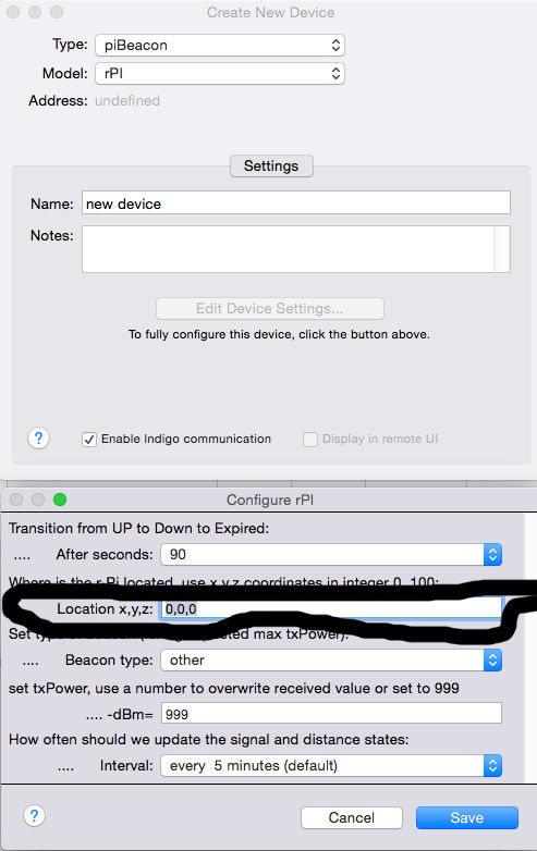

As I see, I have to set up the coordinates of the Pi.
How can I do this?
I think that's the reason it doesn't shows up.

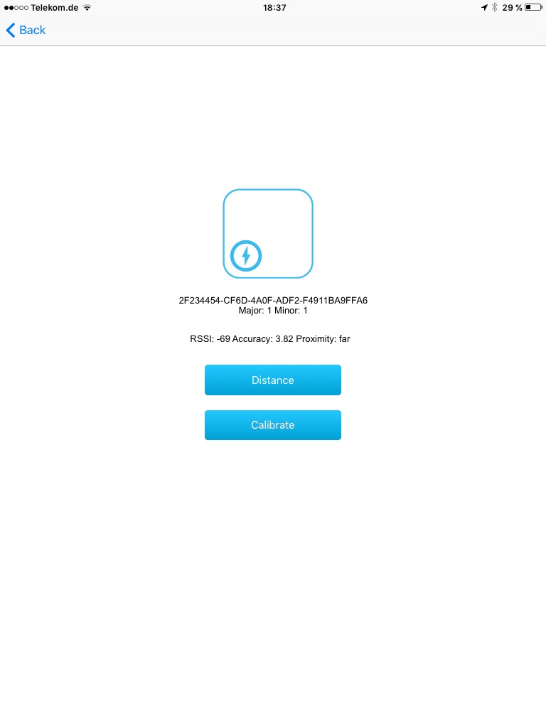

Second, I've tried to test the Pi and the plugin with the App "Locate" from Radius, on my iPad.
There are four buttons. If I go to "Locate Beacons" I can see a beacon, I think it's the Pi.

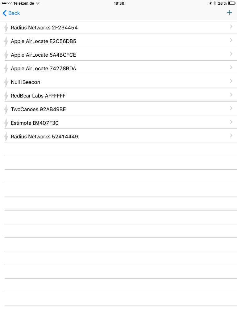

But how can I configure the iPad as a beacon? What to select from the list (see screenshot). Do I have to select the same network (Radius Networks 2F234454)?

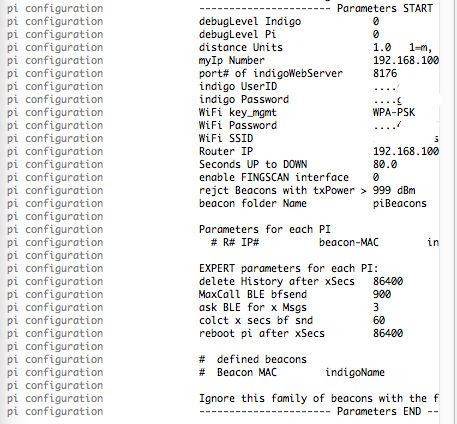

Pi Log
Pi Log
Pi Log.jpg (83.7 KiB) Viewed 6298 times
Yassi,
to your questions:
1. iphone and ipads etc are not easily configured as iBeacons, see discussion in this thread.
2. you need a REAL iBeacon (i.e. radius, xy, ..) to see it in the plugin, see the list of good and not so good iBeacon in the iBeacon thread. The rPi will NOT list non iBeacon devices (= other BLE devices = mouse, keyboards, iPhones, etc), I am look at that, but not so trivial to do.
3. it seems that your rPi is not setup properly,. Did you do "setup pi" in the menu? configure DEVICE MUST be done AFTER the rPi shows up as a device in the folder iBeacon. The plugin must create it first. It will do so once the rPi is sending messages to the indigo server.
4. the iPhone iBeacon scanner will likely show the rPi as a beacon (type radius), and it behaves like a iBeacon transmitter as well as scanner.
In your print config it does not show ANY pi or beacon devices setup.
so here is what your should be doing:
1. menu/piBeacon/setup Pi servers: select rPi#=0 , confirm, enter IP number, enable rPi, ... confirm.. (get the rPi ip number from FINGSCAN or your router)
2. menu/piBeacon/send config to piBeacon: select rPi#0 (should be already done automatically in #1, just do it again.)
3. menu/piBeacon/restartPiServer: re-start rPi#0
4. you then should see changes (after ~ 1 minute) in variable: piBeacon/pi_IN_0:
{"pi_IN_":"0","mac":"5C:F3:70:6D:DA:7A","msgs":[["F1:4C:CE:08:E4:80",1,"0-0-0",-71.2,-2.0,9],["5C:F3:70:6D:D8:E9",1,"0-0-0",-82.4,-59.0,137],["D4:DA:48:4A:C9:F7",1,"0-0-0",-68.0,-2.0,10],["5C:F3:70:6D:D9:6E",1,"0-0-0",-92.6,-59.0,110],["00:EA:23:0B:E2:54",1,"0-0-0",-70.8,-60.0,13],["D4:D4:36:86:9B:60",1,"0-0-0",-67.4,88.0,123]],"secsCol":"17"}
( less than this as I have many beacons and rPis)
5. you then could turn off login in the event log with: menu/piBeacon/Replace Indigo Webserver ... That will add a filter to the default web server to suppress the MANY messages you will be receiving from your rPis
