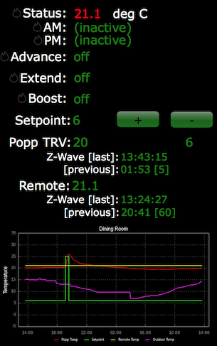

Autolog Example
Autolog Example
In the example above, which is the control page for my dining room, the Popp TRV is reporting every 5 minutes and when and how long ago is updated every 5 seconds. The Remote is also monitored and in this case it is updated every hour. The remote will automatically report if the temperature changes by (I think) 1 deg C (this is device customisable). The graphs are produced courtesy of the the Matplotlib plugin by DaveL17. :)
The Stella-Z plugin was the first plugin I wrote and is showing its age and my lack of knowledge at the time on how to write a plugin (it was a learning experience).
I didn't for example, set-up the Stella-Z devices as Thermostats, which I would do now as I understand how to do it.
I am intending to update it to a more generalised TRV plugin and I have made a start but it got put on the back-burner. :)
