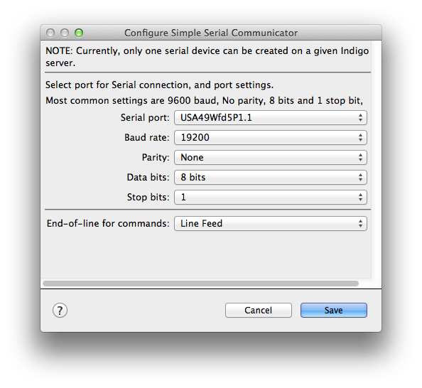

Any progress on having multiple devices (ports) available in Indigo?
Hoping to use a 4 port Keyspan USA49WG. for RS232 control of AV components.
currently running Plugin Version 0.9.3 to control 1 device.
Thanks for a great Plugin!

Korey wrote:Any progress on having multiple devices (ports) available in Indigo?
Korey,
Sorry, at this juncture I do not plan to add anything additional to the Simple Serial Plugin v 0.9.3, as it was intended as just that, a "simple" plugin.
I had been doing a lot of work trying to get serial communications operating, and created this plugin just to check communications before working on a far more complicated plugin. it seemed like something worth sharing, but I really only updated it to a point that it was "operational."
Again, sorry,
Jim
