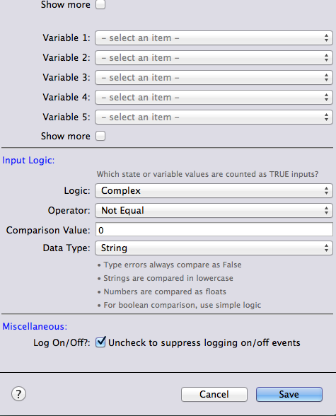

Umtauscher wrote:I defined the true value as complex and definded ten TRUE value as not equal to 0 as string value for a custom state but I cannot get it to fire.
This should work, provided the string the ghostXML device is literally "0".

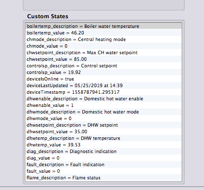

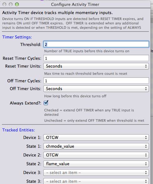

Sorry for the late answer, but I just have managed to make some screenshots.
What I am trying to do here is simple.
Logically I need to create 2 states which show what the boiler is heating:
flame_dhw = flame AND dhw_mode
flame ch = flame AND ch_mode
DHW means hot_water_mode and CH means central_heating_mode.
At the moment I have 3 triggers for this. Unfortuneately it is undefined, which trigger fires first. Normally the mode changes before the flame but sometimes both states change simultaniously and it's not clear which trigger fires first.
When I found out about your timed device plugin, I saw the opportunity to make it more stable.
Unfortunately I cannot get it to work.
I have attached the custom states of the GhostXML device that asks the boiler for its state an one of the timed devices plugin.
Hopefully someone can help.
Cheers
Wilhelm
The upper part of teh device settings
Bildschirmfoto 2019-05-25 um 14.37.40.png (88.08 KiB) Viewed 8276 times
The lower part of the device settings
Bildschirmfoto 2019-05-25 um 14.38.40.png (64.7 KiB) Viewed 8276 times
The custom states of the GhostXML OTGW device
Bildschirmfoto 2019-05-25 um 14.39.00.png (46.88 KiB) Viewed 8276 times
kmarkley
Posts: 187
Re: Timed Devices plugin
Post by kmarkley »
So, first, this isn't the intended use of this plugin, and it's a little wasteful of resources to keep starting and counting down that timer if you don't need it. But on the other hand, it does seem like this should work.
I'm guessing the issue may be comparing regular and unicode strings, although I thought I had dealt with that possibility. I don't have time to dig into it now, but a brief look at the plugin indicates that I misspoke when I said it didn't cast strings as numbers. Try setting the data type to number - I think that might do it.
Also, I think you probably want the Always Extend checkbox unchecked. If you want the plugin device to show as on only when both your other states are non-zero.
Hope this helps.

Just to let you know, the timed device never fires.
I give up, thanks anyway.
kmarkley
Posts: 187
Post by kmarkley »
Just to be clear, the way you have it set up, both of your OTGW states would have to change within 1 second (reset timer) and the n the plugin device would only stay on for 1 second (off timer). This is what this plugin actually does.
You might have better luck converting it to a threshold timer device type and setting a much longer off timer.
