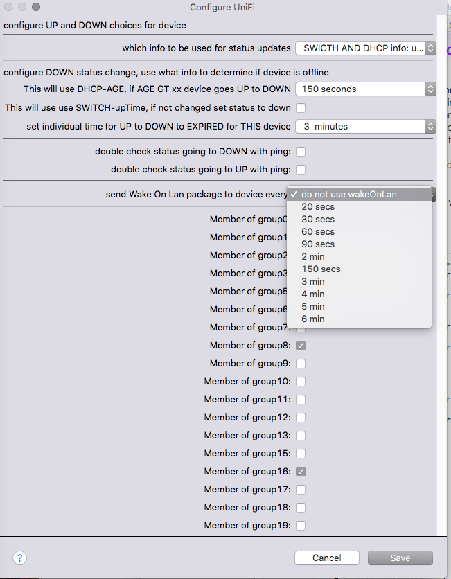

release v 7.16.112

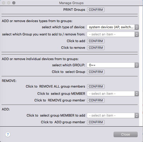

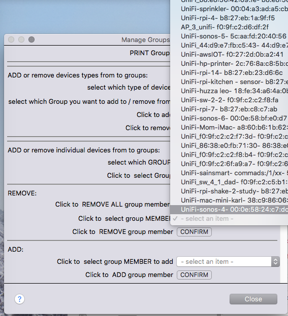

-Added several GROUP functions and report.
-Can now easily add and remove UniFi devices to from groups in a menu.
-Print Groups has a nice overview and summary of groups and members.

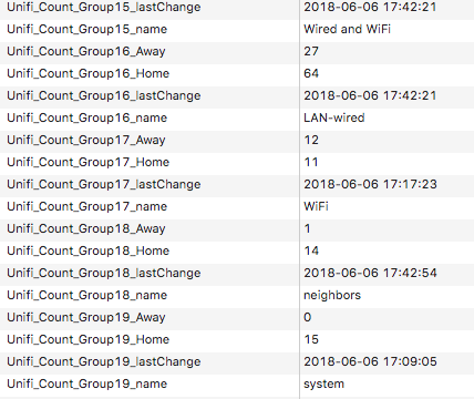

-Added variable Unifi_Groupxx_name. You can set that to eg Wifi or raspberry to rememberwhat is in what groups.
-Unifi_Groupxx_lastChange show the date time stamp of when one device can home or left of THAT group
Added Wake on LAN option for each individual device. Similar to fingscan you can select to send WOL packages to individual devices every xx secs and when they go from up to down .
Fix a bug that cause that device lastupdate was updated at each start.
