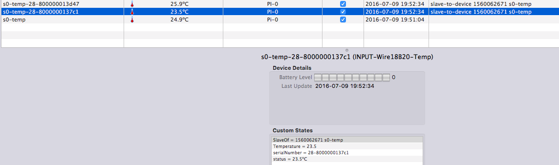

posted v 1.22.1
fixed:
rPi device edit had a typo introduced in 21.1
added One Last Thing:
you now can connect as many OneWire Temp sensors 18B20 to the rPi as you can fit cables into the box. The theoretical limit is 2**64, but only tested with 3.
-You need one resistor 4.7KOhm between pin1 and pin7 and connect to each of the signal wires ;
-connect V+ to pin1(+3.3)
-connect ground to any ground pin eg pin 11
to setup in indigo:
- create a new ONE 18B20 sensor as before.
- connect eg 5 18B20 devices to the rPi and you will get 4 extra indigo devices created. Their name will be the same as device1 + serial number of the 18B20. You will need to figure out which one is which. The serial number of the 18B20 is also a state, see attached screen shot.
To find out which is which hold one sensor into ice water or warm it, then check the change in temperature. -- it can take 2 minutes to change, depending on the sensor refresh setting in the rPi device edit.
SlaveOf value is indigoDeviceId indigoDeviceName
