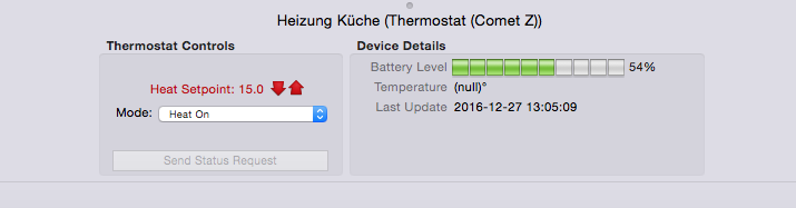

Jon, now I have again an issue, but this time with with the second TRV.
I've installed it yesterday in the kitchen, I was able to sync it, but it doesn't shows the temp.
And ( I thins that's the reason), it heats like hell...
I've already tried to set the heatpoint to 15 degrees or 6 degrees, this seems to work (at least in Indigo is showed), but the temp isn't recognized and the radiator body is still hot!
Wake-up time is set to 5 minutes.
Yassi
Yassi

Re: Autolog Stella-Z Thermostat Controller Discussion
Hi Yassi,
I assume this is the device we are talking about: https://www.eurotronic.org/fileadmin/us ... DA_eng.pdf
What happens (in Indigo) if you use the wheel on the Comet to change the temperature?
I would try and re-sync it as the next step to see if that corrects the temperature problem.

Hi Jon,
yes, that's the device.
I've tried today, before I've posted, but it doesn't shows the temp (null) and shows the error log.
Now, the radiator isn't heating, or at least, it's colder, good sign.
But still the issue with the temp.
As far as I know, if I use the wheel, then no communication with Indigo is possible - for 2 hrs.
Can you see something about the temp sensor in the dump here?

zwManufactureName : EUROtronic (string)
zwMeterSubTypeFlags : 0 (integer)
zwMeterSupportsReset : false (bool)
zwMeterType : 0 (integer)
zwModelDefnVers : 1 (integer)
zwModelId : 131073 (integer)
zwModelName : Thermostat (Comet Z) (string)
zwNodeNeighbors : (list)
Item : 4 (integer)
Item : 10 (integer)
zwNodeNeighborsStr : 4, 10 (string)
zwProtoVersMajor : 3 (integer)
zwProtoVersMinor : 67 (integer)
zwShowMainUI : true (bool)
zwShowPollingUI : false (bool)
zwShowWakeIntervalUI : true (bool)
zwWakeInterval : 5 (integer)
pluginId : com.perceptiveautomation.indigoplugin.zwave
protocol : ZWave
remoteDisplay : True
states : States : (dict)
batteryLevel : 54 (integer)
batteryLevel.ui : 54% (string)
hvacOperationMode : 1 (integer)
hvacOperationMode.ui : heat on (string)
hvacOperationModeIsAuto : false (bool)
hvacOperationModeIsCool : false (bool)
hvacOperationModeIsHeat : true (bool)
hvacOperationModeIsOff : false (bool)
hvacOperationModeIsProgramAuto : false (bool)
hvacOperationModeIsProgramCool : false (bool)
hvacOperationModeIsProgramHeat : false (bool)
setpointHeat : 6 (real)
temperatureInput1 : 0 (integer)
temperatureInputsAll : (string)
subModel :
supportsAllOff : False
supportsStatusRequest : False
temperatureSensorCount : 1
temperatures : [0.0]
version : 0Re: Autolog Stella-Z Thermostat Controller Discussion
Hi Yassi,
Can't see anything wrong with the dump.
Have you tried waking it up - press the button in the battery compartment - that might cause the temperature to update?
If that doesn't work, try re-syncing.
