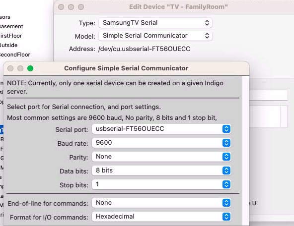

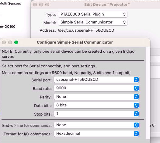

Vig
Posts: 110
Joined: Tue Oct 06, 2015 8:09 am
Re: Newer version of Indigo 2022.x.x
Post by Vig »
Hi Ham,
I don't believe it's a plugin issue. I don't think USA19H has a compatible chipset driver that works with Ventura. I had one and had to toss it when I upgraded to BigSur since it stopped working. Instead I got this one below and it works as intended.
https://www.amazon.com/gp/product/B08P24ZQ1B
Screenshot 2023-04-16 at 10.09.48 PM.png (150.48 KiB) Viewed 3176 times
Screenshot 2023-04-16 at 10.10.41 PM.png (140.71 KiB) Viewed 3176 times

Vig
Posts: 110
Post by Vig »
Yes, I believe I had to install their driver. The driver comes on the disk or you can download it here
https://www.gearmo.com/shop/4-port-usb- ... ndicators/
The driver/version is FTDIUSBSerialDextInstaller_1_4_7
