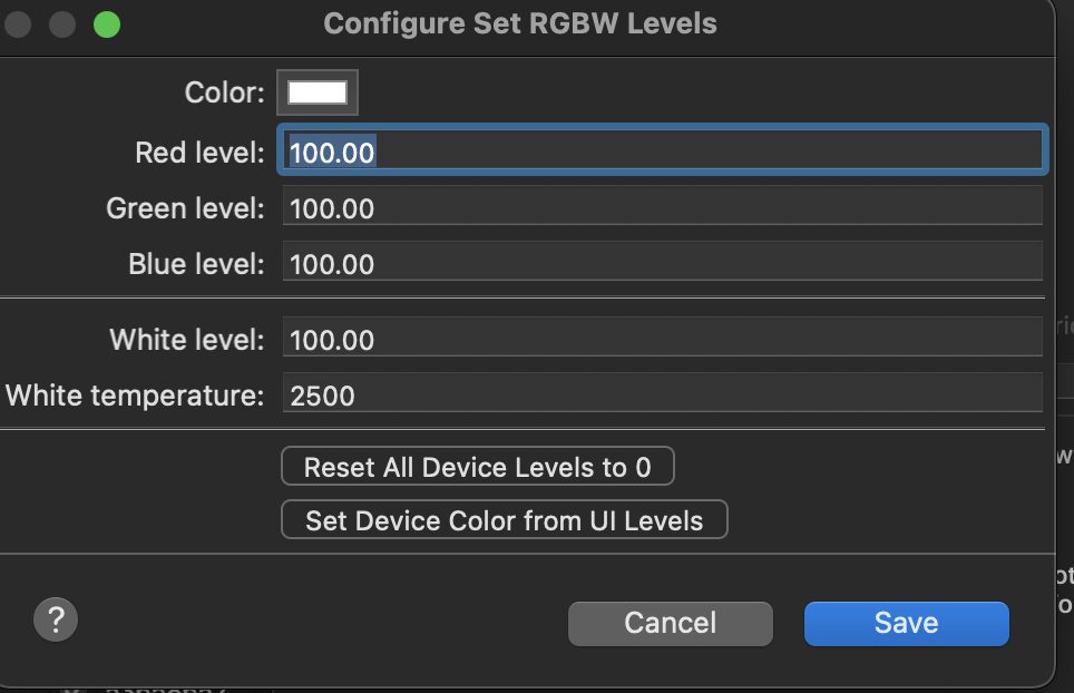

Hi Jon, so found time whilst on dull conference calls to test. The gui seems to work ok when setting colour temp, but the action doesnt appear to, so using triggers to either directly set colour or call an action group doing so, doesnt seem to work. Looks like it changes it to white but that is it, the colour temp doesnt get sent or applied.
autolog
Posts: 4077
Location: West Sussex, UK
Re: Hubitat Plugin Beta
Post by autolog »
What settings are you using in the Action Group - can you do a screen capture for me?
Also, I need to see the debug MQTT log for when the command is executed.
That is set in the plugin config under Hubitat MQTT Filtering - just select the one device. :)

Hi Jon, Is this the detail?
Looks like its sending the white colour as defined by the RGB values in teh screenshot, and not the colour temp. Indigo wont let me leave the RGB values blank.

Aaaaahhhhhh.... I need to set the RGB levels to zero!

siclark wrote:... Aaaaahhhhhh.... I need to set the RGB levels to zero!
Can I assume that it is now working OK for you (looking at the second set of logs)?
Indigo currently only has one dialogue for setting the RGBW levels.
Ideally Indigo would have options for only RGB or only W as well. It is obviously currently catering for those situations where a device can have all the RGBW settings set at the same time?
The only way the plugin can tell whether you want to alter RGB or W (as you have discovered) is by having the RGB values at zero in order for the plugin to understand you want to alter the W and color temperature. It goes through a small bit of logic to work out what you want alter.

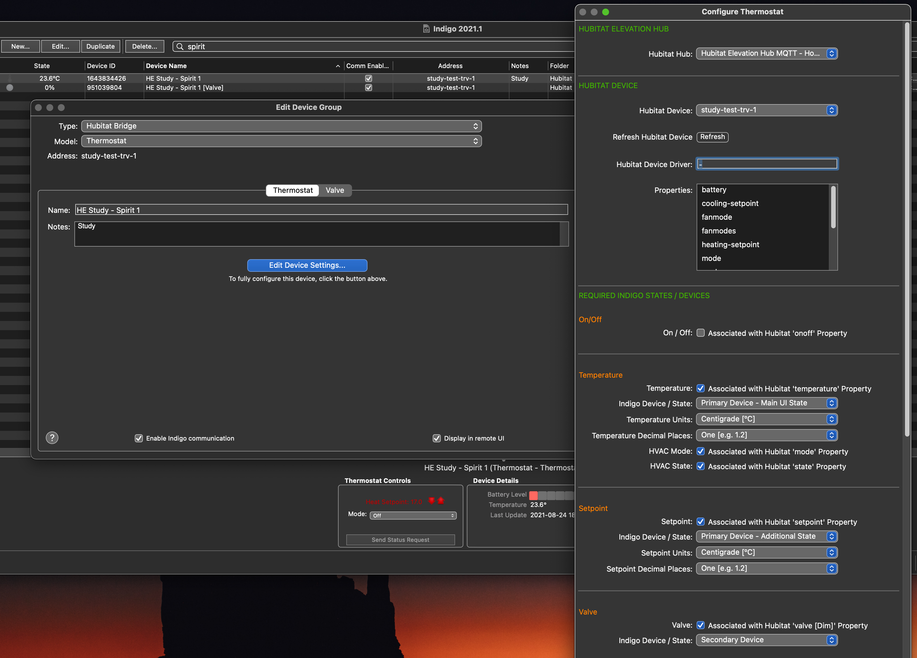

siclark wrote:Now wondering if there is a way to move my Spirit TRVs to the hubitat and stop all the zwave messages interfering with my lights control on indigo! If only I could use 2 different zwave sticks on Indigo!
Yes, I have had the same idea about connecting all the Spirits to Hubitat so that they don't affect Indigo so much.
I have a number of test Spirits and I have set one up in Hubitat to test it.
When I first looked at it a number of months ago, I couldn't get the level of control I was looking for.
The plugin does cater for a device type of Thermostat and also the Valve.
Screenshot 2021-08-24 at 20.52.33.png (1.67 MiB) Viewed 3286 times
I will have to revisit it.
However, I have also got two Z-Stick 7s (Series 700). I have one running on my development system and need to byte the bullet and install the other one on my production system (replacing my Z-Stick 5). I am hoping that this might make a difference to the control of the Spirits. we'll see.
