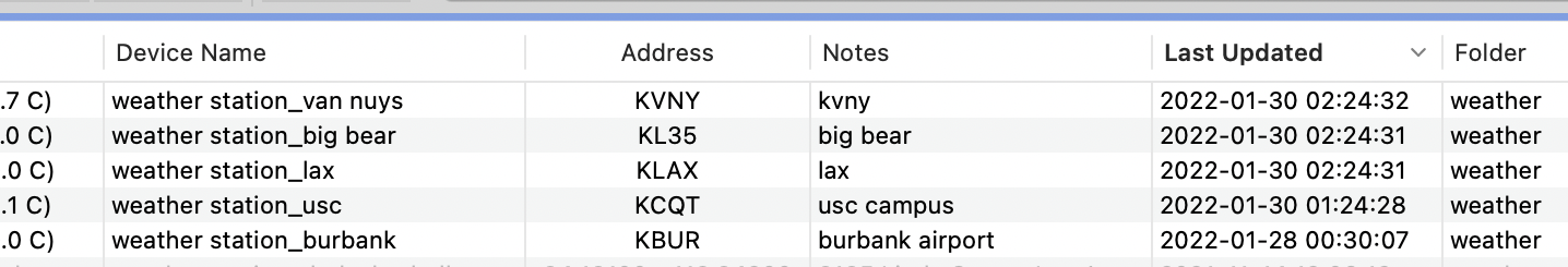

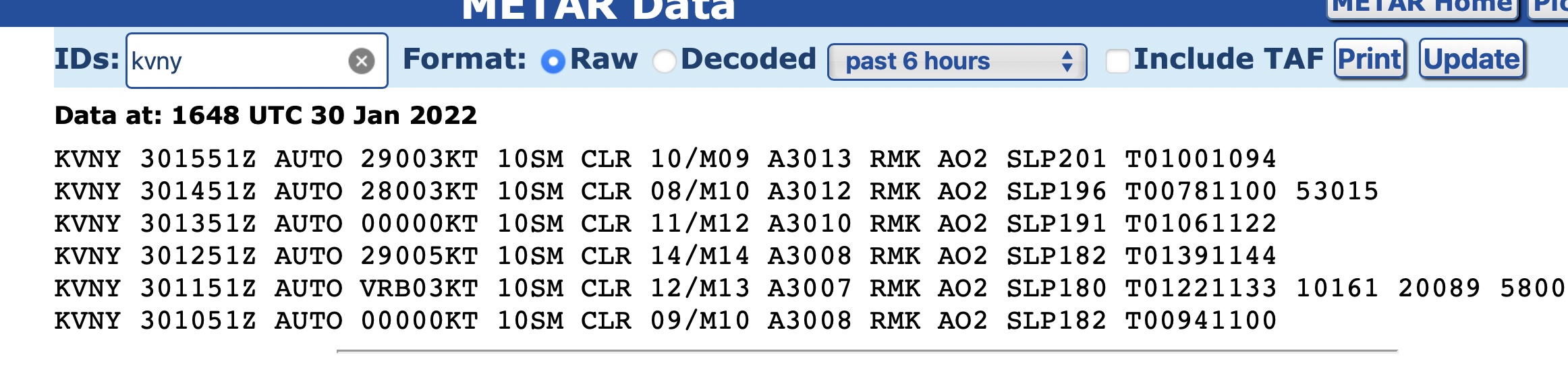

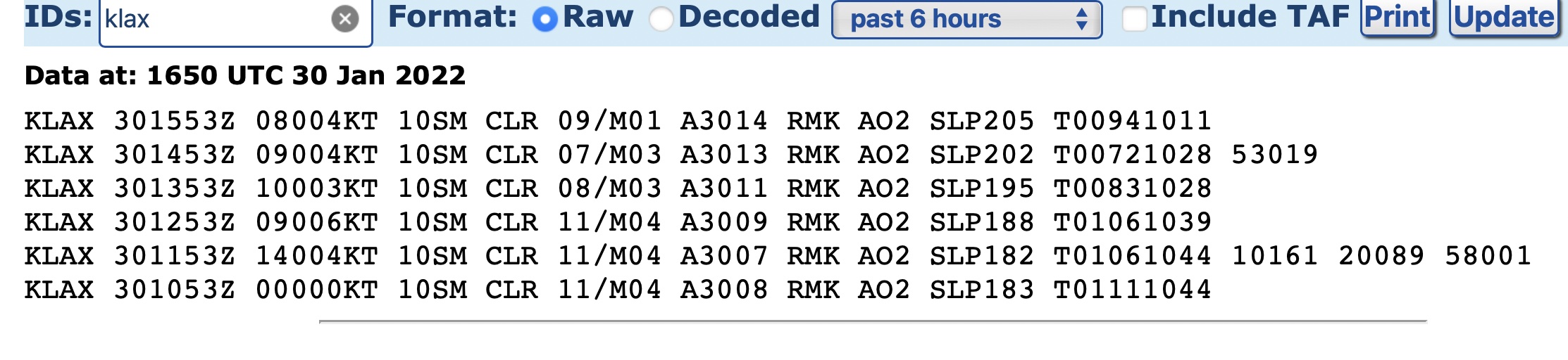

hey @jay, another anomaly... this am i wake to find the system on the third fallback airport, the first two being not updated in hours, since 224am local.
but when i check metars reports exist for every hour... even after reloading plugin no update. to what do we attribute this?

BTW, you'll note in my post above that the KATT station, the Austin airport, hasn't updated since early this morning.
In fact, all of the stations that I've set up for testing (all of yours and a couple for me) have been dark since at least the same time this morning if not earlier. I'm beginning to suspect that this NOAA data source is just no longer very reliable...
I'm going to keep an eye on this for the next month or so. If the data continues to be generally spotty (as opposed to spotty for just a few stations), we may have to stop including it with Indigo and put a big warning in the plugin store that the source doesn't appear reliable. If anyone has any contacts in NOAA, now would be a good time to see if they know anything.

So, this seems like it might be a NWS issue. What I see are the XMLs in their DB are as the plugin indicates: old by 6 hours or so now. BUT, the current raw observation data on the site is up-to-date for the last hour.
It seems the stations are updating but NWS/NOAA is not making XMLs...? Really don't get that. Perhaps they're having a system-wide issue with file formatting or database handling.... I see no errors anywhere on their site, no red flags. This seems really dangerous to me. But I suppose only non-critical civilian users get the info from the XML? No idea really.

dtich wrote:@Jay, what do you think? Does this sound plausible?
No. We're not using a browser (which might be susceptible to caching). We're directly accessing the URL every time without any possibility of caching. What we get is what they're returning every time.

NOAA stations reported very consistently for a couple weeks, then went awol again. i notified the webmaster and this is latest response. just fyi. not really sure what we do about this if the caching is on their end... just to update:
Hello Dylan. I apologize for the issues. Were you able to try the random string trick at the end of the url. As I mentioned before, it may not be so much an issue with caching done at the local level, but from our akamai caching service at the server level. This trick would help if that is the issue. Anothing think I would be curious about is the next time your script pulls old data, manually visit the page on your web browser and let me know if the data is still old, if so, try it again manually with a ?randomstring .
I am also sending your issue up to our regional and national web teams.
Here is a summary of the issue:
Dylan is using a script to grab xml feeds like: https://w1.weather.gov/xml/current_obs/KVNY.xml but the data is not being updated in a consistent manner. Often times the data returned is old. The data is being used to control irrigation systems. Any additional input would be appreciated.
Thanks.
and then this:
Hi Dylan,
Here at the regional headquarters, we typically use the APIs to gather our observation data. We often use synoptic, which will provide you with data in json format or xml (https://developers.synopticdata.com/mesonet/explorer/). Weather.gov also has an API for forecast data, which is very stable (https://www.weather.gov/documentation/services-web-api).
I'm not involved with the maintenance of the w1.weather.gov xml service, but just wanted to let you know what I use as a data source.
