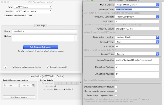

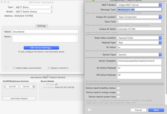

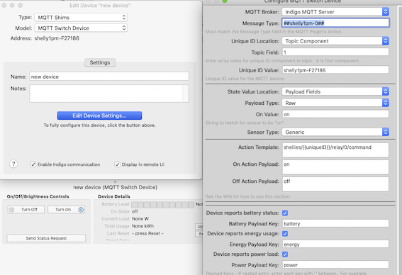

2 bugs
1)
Changed Line 212 to SensorOn and now OK
2)
Tick the 3 new UI options, battery level, Energy and Power usage and they all appear, untick all 3 and Battery level remains, only the Energy and Power disappear as expected.

2)

Cannot reproduce. Worked for all device types I tried it with. What was the specific device type you saw this with?CliveS wrote:2)
Re: Releases, Bugs, Issues, Requests
It was a Shelly 1PM, I thought I was in the Shelly DW and hit the battery tick box.
Just duplicated the Shelly Dimmer and that acts the same and if I untick the Shelly DW battery it still show in the UI even after reloading Shims or Indigo.
What's the exact sequence of actions again?CliveS wrote:It was a Shelly 1PM, I thought I was in the Shelly DW and hit the battery tick box.
D'oh. I thought you said the UI entry field (for the payload key) wasn't going away.
Hmmm.
