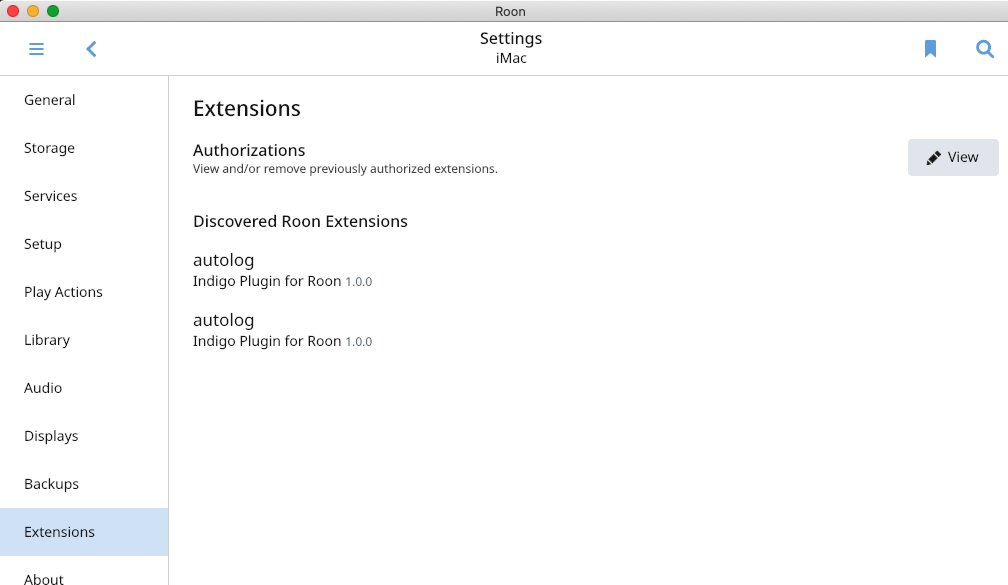

autolog
Posts: 4077
Location: West Sussex, UK
Re: Roon Controller Plugin Beta feedback.
Post by autolog »
Stoutjesdijk wrote:When I try to configure the Roon plugin, I get a spinning wheel for a while, and then nothing. Why would this happen? My roon core runs on a Synology NAS.
When the plugin starts-up it will require to be authorised by Roon - there should be a message in the Indigo Event log indicating such.
If you haven't done this, go to the Roon Controller, Open Settings and select the Extensions tab and click Enable on the autolog Roon extension.
Hopefully this is the issue, if not we will have to dig deeper. :)

I don't think you have authorised the plugin in the Roon App settings (as highlighted in my previous post). ;)
Roon > Settings > Extensions
The plugin doesn't have to run locally to Roon. I am running the plugin on my development Mac and it is accessing Roon on my production Mac.
Hopefully the above will resolve the issue for you; if not I will investigate further with you. :)
