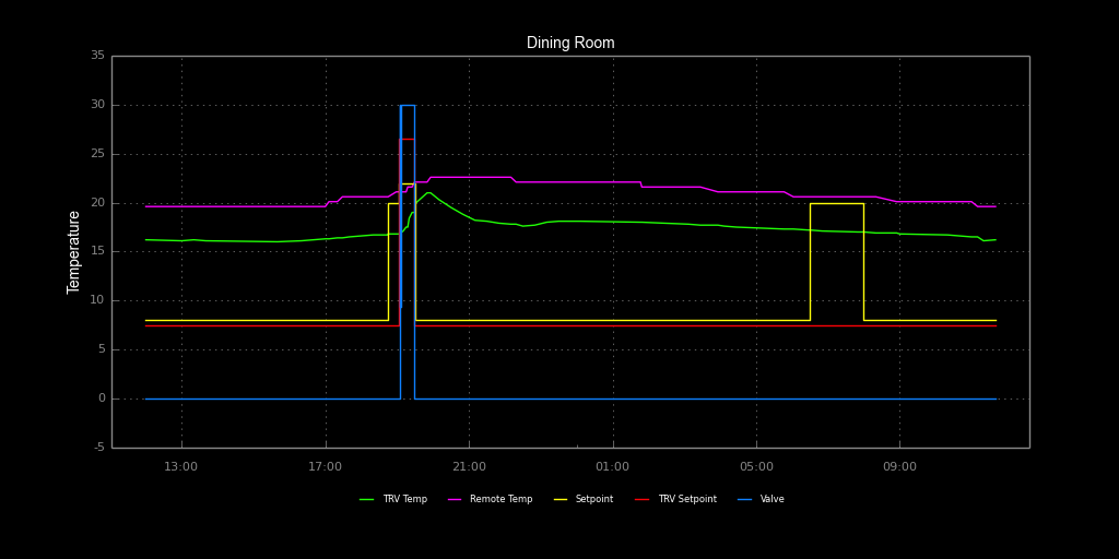

Here is an example graph produced by the Matplotlib plugin (Thanks Dave [@daveL17] :) ) that is displaying the CSV data produced by the plugin for a TRV Controller device:
Example Matplotlib graph for TRV Controller
MATPLOTLIB - T02 - Dining Room.png (25.82 KiB) Viewed 4918 times
My Control panel setup has a list of rooms and selecting (in this example) the Dining Room links to a specific Control panel page giving details of the dining room and displaying the graph as a refreshing image. On the parent control page, I set two server actions: the first to update All the CSV files for the device and the second to redraw the Matplotlib graph with a delay of three seconds.
Hope this might be a useful use case. :)

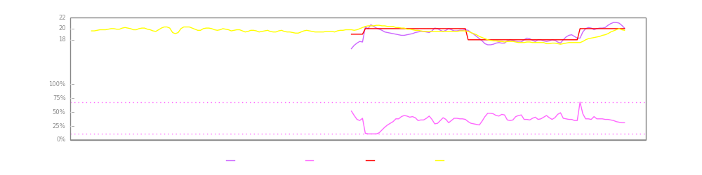

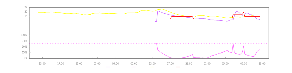

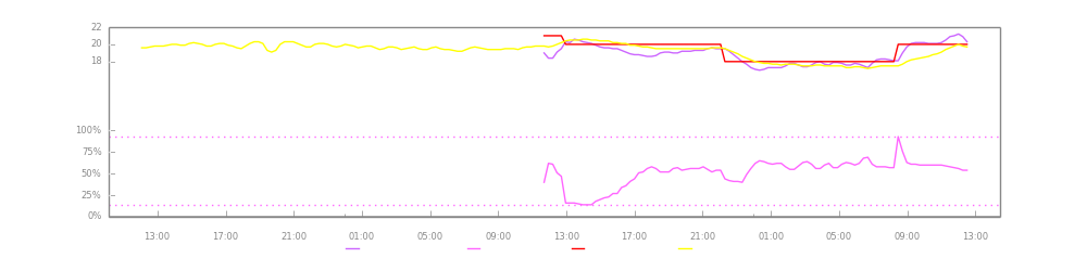

I setup graphing on how the Spirits performed three of the TRVs.
I thought it was quite enlightening about how they work.
Only the first 24 hrs of report so far.
** These are designed for display on a black background so legend doesn't show up well on this.
Red is setpoint, yellow actual temp in room, pink purple at the top is reported TRV Temp, pic/purple at bottom is Radiator Valve %
Master Bedroom Radiator
Chart - Radiator - Master Bed.png (22.47 KiB) Viewed 4723 times
Lounge Front Radiator
Chart - Radiator - Lounge Front.png (23.11 KiB) Viewed 4723 times
Lounge Back Radiator
Chart - Radiator - Lounge Back.png (23.67 KiB) Viewed 4723 times
This is using DaveL's Matplotlib plugin
I was struggling to understand why the valve was changing when the temp had not been reached, but with the graphs you can see what it is doing.
I'm impressed :-)
