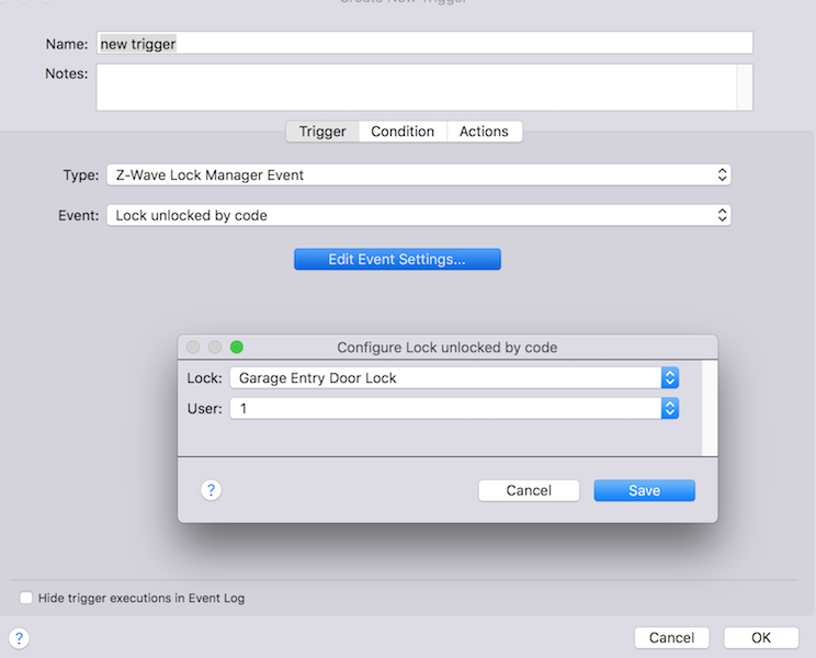

Just curious...when the lock is unlocked...does it send Indigo the code used? I'd like a way to keep track of who last controlled it and email a message.
Like define variables User 1, User 2, etc. and fill in a name for each. Then when the lock is opened it would allow matching the code to a user #, which then can match up a name and send an email stating "Ross unlocked the front door at 12:51pm on Nov 25, 2016" or something like that.
Just to have a history at least in email of who opened the lock. And if done via Control Page it could log that too.
I don't know if the protocol supports it, but I figured I'd ask just in case someone already knows the answer.

Not exactly the way you want, but you can create a Trigger for each user that unlocks the door, and send an email or set a variable to display on a control page. When you create the Trigger, you specify which lock and which user. Then set actions to do what you want. Then duplicate that trigger for each different user. It does not send/display the code, just the user whose code was used.srkinard wrote:Really cool!![]()

Where does it tell the user who unlocked it? The only device states I see are the batteryLevel, LastChangedVia and the onOffState to pull info from.FlyingDiver wrote:Not exactly the way you want, but you can create a Trigger for each user that unlocks the door, and send an email or set a variable to display on a control page. When you create the Trigger, you specify which lock and which user. Then set actions to do what you want. Then duplicate that trigger for each different user. It does not send/display the code, just the user whose code was used.
LastChangedVia only says "keypad" when someone enters a code.
Ross

YOU specify which user the trigger applies to, so your actions for that trigger already know. If you specify "Any User", well, then you don't know.srkinard wrote:Where does it tell the user who unlocked it? The only device states I see are the batteryLevel, LastChangedVia and the onOffState to pull info from.
