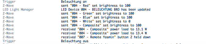

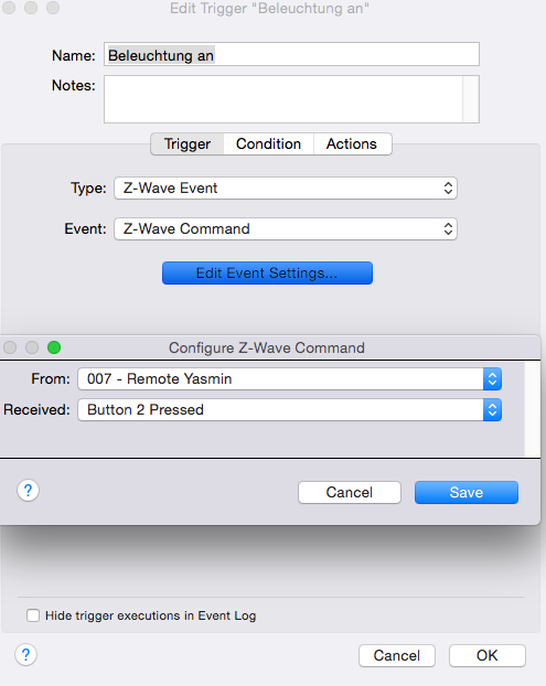

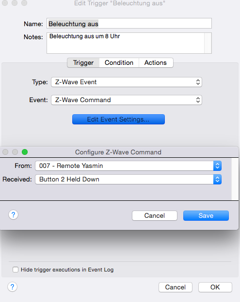

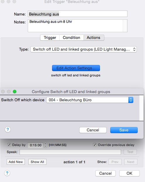

But I have now an issues, I don't know if it directly related to the plugin.
I've got an Aeon Keyfob (ZW088), and set up Button 2 (on press) to switch on the LED lights.
This is working well.
(As triggers).
And set up the same button, but on held to switch off the lights.
This is shown in the log, but the lights remain on.
Do you have an idea what could be wrong?
(See attached pics)
