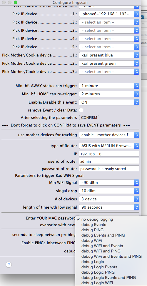

Because I am using a asus rt-ac68u router, I want to use the router informatie in fingscan. I am using Merlin version 378.55.
Seems like fingscan can not connect to the router. I am getting the error:
Router wifi not reachable, userid password or ipnumber wrong?
I did enter the right ipnumber, username and password. Is there anything else what I should do?
Regards Wouter

could you switch on WIFI debug?

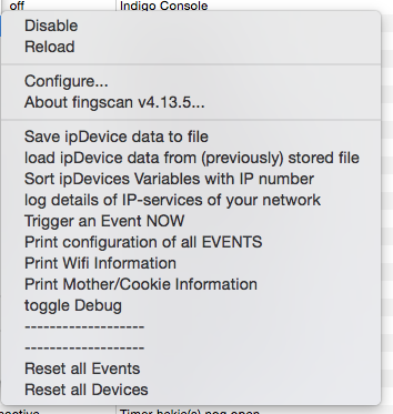

Post by WouterK »
I only see the "toggle debug" option is that what you mean?
(Sorry, newbie)
Wouter
in config you can select the debug level at the bottom, I have split this into sections as other wise your log file gets swamped

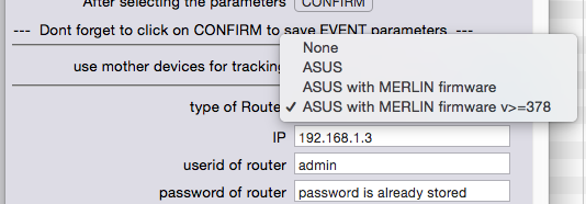

Joined: Wed Aug 19, 2015 3:07 am
Post by WouterK »
No WIFI Debug sorry:
These are options I have
Regards Wouter

it is in menu/ Configure
