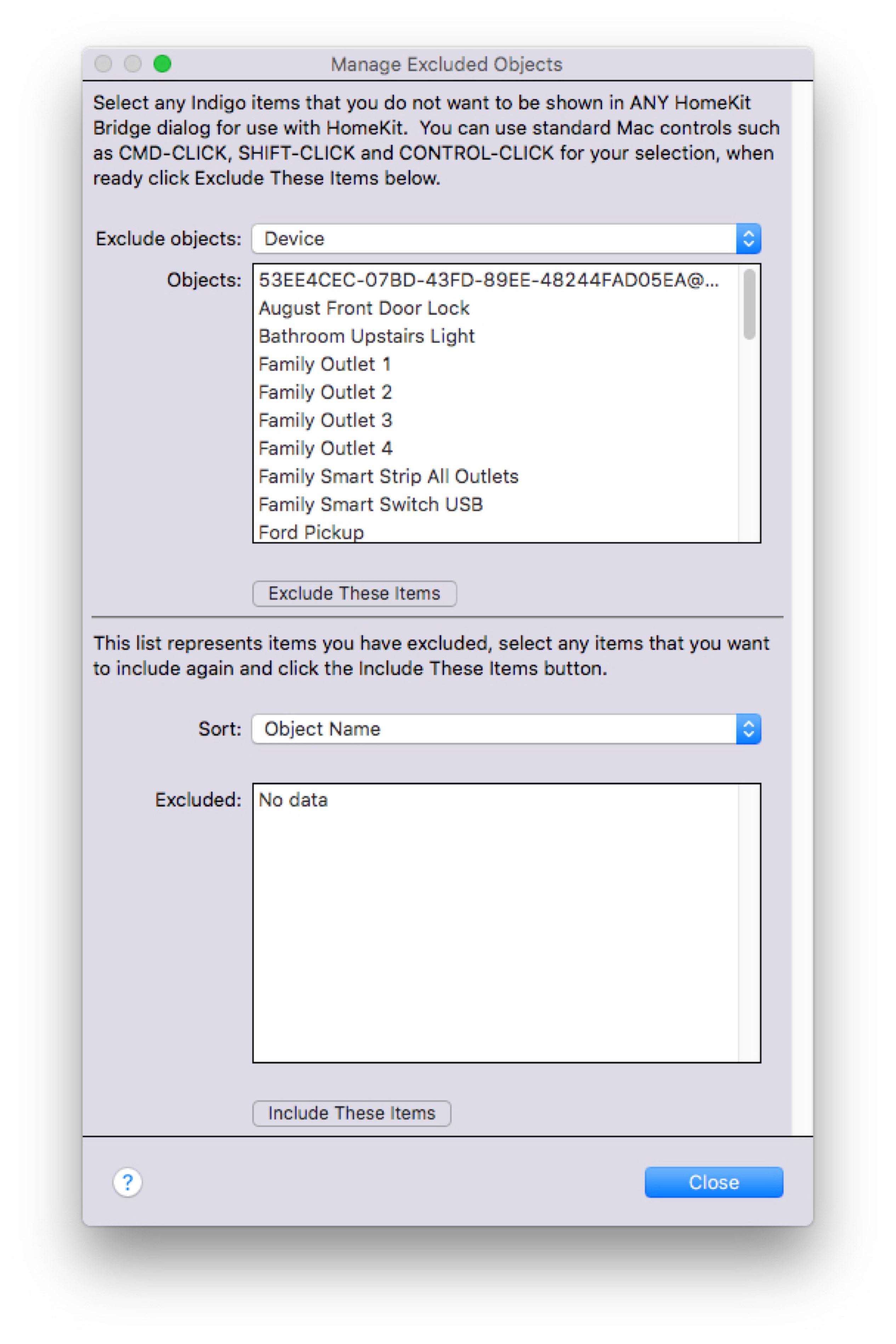

This is my first post since installing the HBB beta 16.3 and I never tested any prior versions. There was some discussion on the UI, but I found the UI works very well. Yes, one has to spend some time with it, but that is the case with anything else these days. I greatly appreciate your time and effort you have put in this project. HBB and now HBK has given my family members easier access to control my home.
Of course, I also ran into a few issues, but I expected this.
- - HBB created a new Indigo device automatically and I expected the same from HBK, which caused me to keep looking for it in Indigo. Obviously creating advice after installing a plug-in is the standard option in Indigo and that is what I ended up doing. I don't really remember seeing this mentioned anywhere in the Wiki. It was not a big issue, but since we are on the subject of making this plug-in easier to use, it might help others, especially if they come from HBB.
- If there was to be some kind of migration from HBB to HBK, I never saw it take place?
- I have one of those Aeotec Smart Energy Strips (DSC11) and HBK mapped it to switch, but I changed it to outlet, which then caused my HBK to not start. I changed it back to a switch, but it took me a little while to get the server running again going through some of the troubleshooting steps listed here.
- As I started to add Indigo devices, I went back and forth excluding additional Indigo devices in the plug-in or enabling them again. The plug-in now does not show the devices excluded but instead reads "No data"? I now have lost access to these devices and all of my troubleshooting steps did not solve this issue. At one point my already HBK defined devices came up without any device selected and when I tried to save it, it informed me of this and deleted the device from HBK. I had a random number of different devices that lost its device selection and the device(s) now longer is listed, which made me go back to the HBK plug-in menu "Managed Excluded Objects" and noticed that nothing is listed in the excluded section. What else can I do, to get these devcies showing up again?

This is an awful lot of "fail" in one message...
This was the case for about 5 betas and I removed it, the plugin will not create a new device or migrate HBB when installed because I wasn't sure if that was causing another startup issue where the plugin config dialog would not pop up. While it ended up not being the issue I left it out anyway for the time being.mlooss wrote:HBB created a new Indigo device automatically and I expected the same from HBK, which caused me to keep looking for it in Indigo.
This goes with my first response. It did happen automatically for a couple of releases and then I took it out. It's still available in the Advanced Plugin Actions menu (and that is stated in the Wiki).mlooss wrote:If there was to be some kind of migration from HBB to HBK, I never saw it take place?
This really does't make sense. Changing a type doesn't do anything to Homebridge except that when it loads it re-reads the config and changes the type. So it not starting is likely something else completely unrelated. Have you tried looking at the Homebridge logs to see what may cause it to fail? Anything short of that is purely speculation. I have four of these strips, they work fine and I've also changed them from switch to outlet and have not had any such problem.mlooss wrote:I have one of those Aeotec Smart Energy Strips (DSC11) and HBK mapped it to switch, but I changed it to outlet, which then caused my HBK to not start. I changed it back to a switch, but it took me a little while to get the server running again going through some of the troubleshooting steps listed here.
No clue why that would happen, but you can simply delete your plugin preference file (or rename it) and all of your excluded devices will be included again. Judging from the first line in your screenshot you have some really odd device in there that may be causing it. Do you have a device named like that, a GUID, in your system?mlooss wrote:As I started to add Indigo devices, I went back and forth excluding additional Indigo devices in the plug-in or enabling them again. The plug-in now does not show the devices excluded but instead reads "No data"?

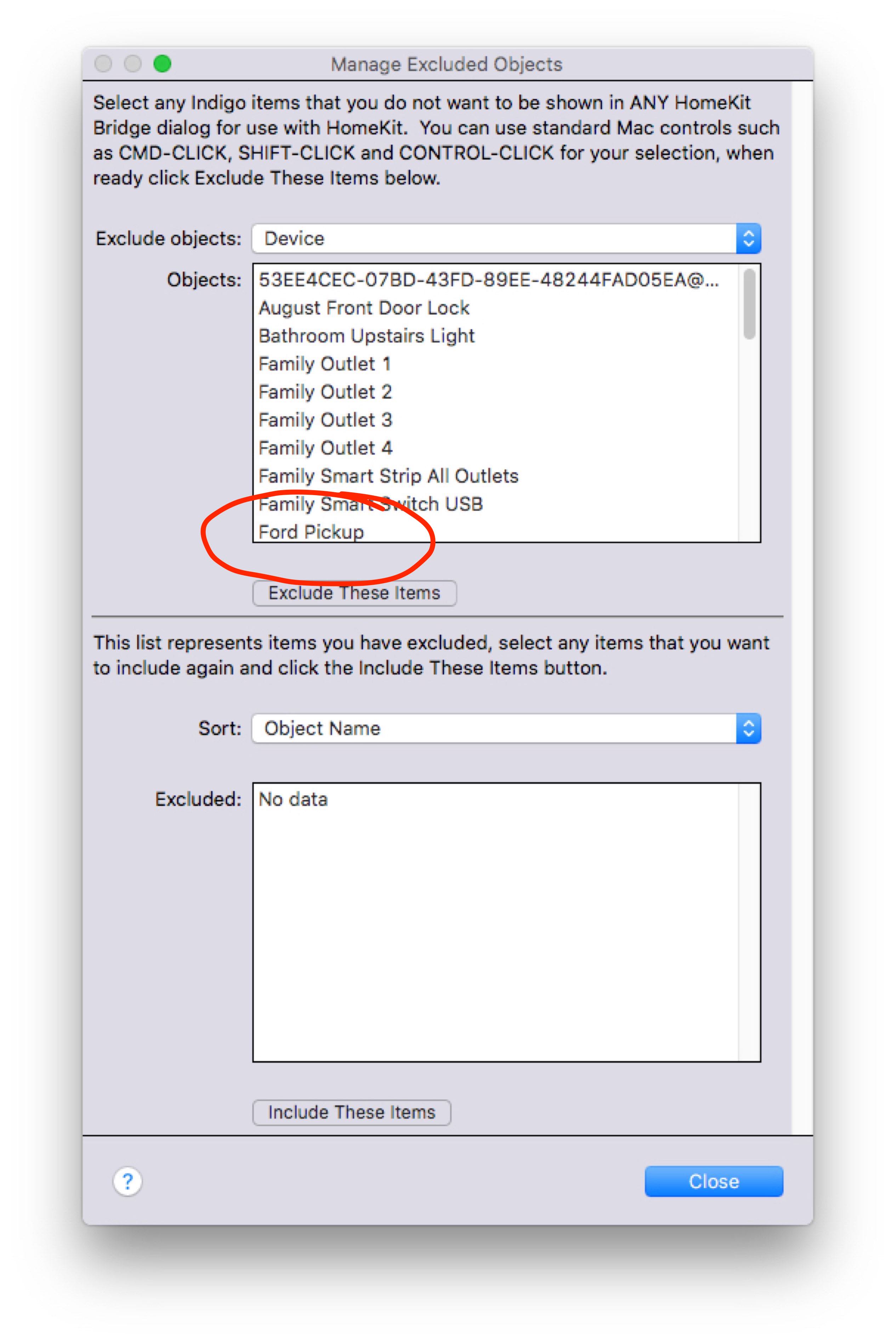

And on a totally unrelated note, I want whatever plugin lets you control your truck...
