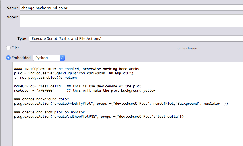

Re: INDIGOplotD -- a plot tool for indigo
just a teaser ...
#### INDIGOplotD must be enabled, otherwise nothing here works
plug = indigo.server.getPlugin("com.karlwachs.INDIGOplotD")
if not plug.isEnabled(): return
nameOfPlot= "test delta"  ## this is the devicename of the plot
newColor = "#F0F000"	  ## this will make the plot background yellow
### change background color
plug.executeAction("createOrModifyPlot", props ={"deviceNameOfPlot": nameOfPlot,"Background": newColor  })
### create and show plot on monitor
plug.executeAction("createAndShowPlotPNG", props ={"deviceNameOfPlot":"test delta"})
put this to an action and see the background color of the plot named "test delta" to change to yellow
create an action for day time and one for night time to change background colors of your plots..

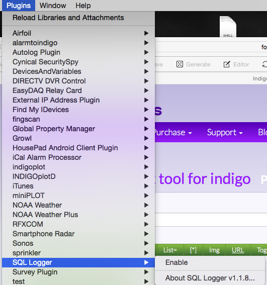

IF SQL LOGGER is not enabled and you select it INDIGOplotD will reset it.
==>>> please enable SQL logger like this ..
Screen Shot 2015-03-05 at 11.44.45 AM.png (153.07 KiB) Viewed 4819 times
first
only THEN select SQL import in INDIGOplotD
{EDIT}
sorry i misread your post. So you don't want to use SQL LOGGER .. and it reenables itself? I will check
Håvard
found it.. YES SQL is re-enabled after 2 minutes when you disable it. Will post a fix soon.
