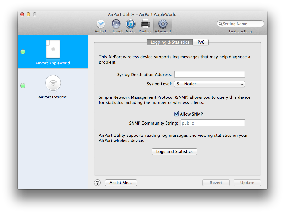

Screen dump from the Airport Express

McJohn wrote:I installed the old Airport Util
http://www.macinstruct.com/node/491
BUT it seems to be that SNMP is totally disappeared in the new Airport Extreme 2013.
Screendump with the Airport Express
and a screendump with the new Airport Extreme
Only syslog can be enabled, but that's a problem for me because I don't know how this works.
Kind regards,
John
Damn... hopefully that is just because the new Airports aren't supported by the old utility? I like the direction Apple is headed on most things, but when it comes to this sort of thing, stripping away features (In the new utility) because to some people they are confusing, it really is disappointing. Hopefully someone here can help you out.

Dewster35 wrote: Damn... hopefully that is just because the new Airports aren't supported by the old utility? I like the direction Apple is headed on most things, but when it comes to this sort of thing, stripping away features (In the new utility) because to some people they are confusing, it really is disappointing. Hopefully someone here can help you out.
Unfortunatly, SNMP is not listed under the Tech Specs for the new models:
Interoperable with 802.11a, 802.11b, 802.11g, 802.11n, and 802.11ac-enabled Mac computers, iOS devices, Apple TV, Windows-based PCs, and other Wi-Fi devices
NAT, DHCP, PPPoE, VPN Passthrough (IPSec, PPTP, and L2TP), DNS Proxy, IPv6 (6to4 and manual tunnels)
It is listed under the Express specs:
Interoperable with 802.11a, 802.11b, 802.11g, and 802.11n-enabled Mac computers, iOS devices, Apple TV, Windows-based PCs, and other Wi‑Fi devices
NAT, DHCP, PPPoE, VPN Passthrough (IPSec, PPTP, and L2TP), DNS Proxy, SNMP, IPv6 (6to4 and manual tunnels)
Good job Apple! :roll:

That's right Korey, I read the same specs on the Apple site this morning :( .
The Wifi range of the new Airport is larger, and it's a nice product, BUT without SNMP (I think it's the hardware, not the utility)
The simplicity of connecting Smartphone Radar with Airport is perfect for me.
So, I decided to install an extra "old" Extreme to extend my Wifi range and hope that Apple
never makes a firmware update for the "old" Extreme and removes the SNMP....

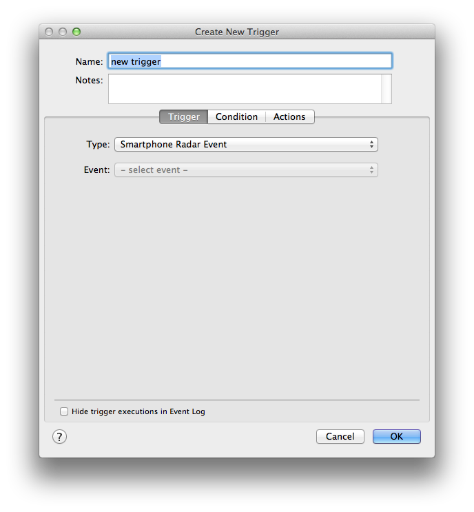

I can't seem to add a Smartphone Radar Event.
I create a new trigger, and "Event" is greyed out not allowing selection.
Plugin seems to be functioning properly showing states of devices:
Jun 20, 2013 4:18:42 PM
Smartphone Radar All smartphones are now Away.
Any Ideas?
Indigo: V6.0.0 b10
Plugin: v1.1.3
