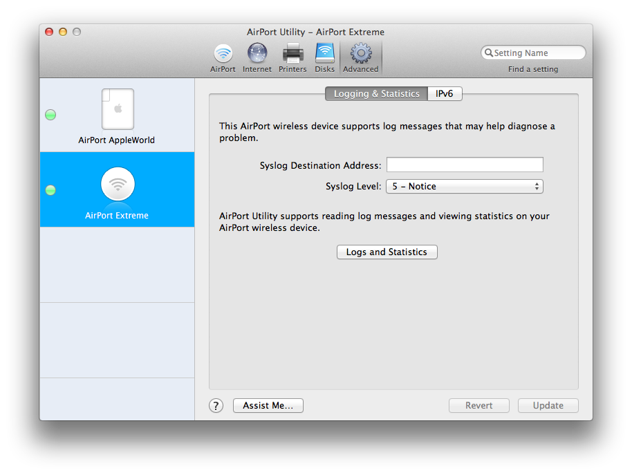

I'm having some problems with this plugin. When I trying, my iPhone is detected as away pretty fast, but it isn't detected as home unless i reload the plugin. I am using wifi sync.
I'm using Indigo beta 7 with an Iphone 5 on 6.1.3.
Also where do you see the syslog in indigo? I cant see it in the event log?

Hello,
I just installed the new Airport Extreme 2013 but the standard SNMP password doesn't work anymore:
Smartphone Radar Error The SNMP request from 192.168.178.88 timeout out. Wrong password?
Has anyone experience with this?
Thanks for the help and kind regards,
John

Re: Smartphone Radar - Smartphone presence detection (Update
I installed the old Airport Util
http://www.macinstruct.com/node/491
BUT it seems to be that SNMP is totally disappeared in the new Airport Extreme 2013.
Screendump with the Airport Express
and a screendump with the new Airport Extreme
Only syslog can be enabled, but that's a problem for me because I don't know how this works.
Kind regards,
John
Kind regards,
John
