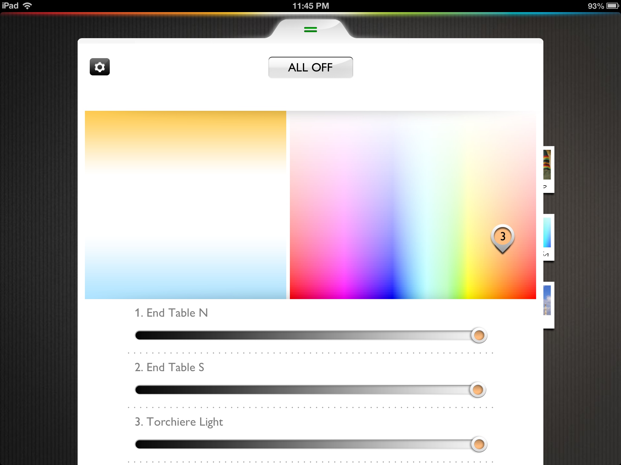

Just noticed that when the lights colors are all set to 255, which I assumed would be white,
they are actually quite dim and rather orange as shown in the Hue app.
Any idea why that may be?

Does this always happen or just every once in a while (if only occasionally, have you noticed a pattern)? I couldn't get mine to do that by using the Set Red/Green/Blue Levels action.
On a related note, the Hue bulbs aren't true RGB bulbs, so you won't get accurate colors using the RGB method (or HSB method, for that matter). Still, RGB values of 255/255/255 should be much whiter than illustrated in that screen shot.

Yes, it does happen each time I set them to full 255. Dragging the lights in the Hue up to white
does brighten them quite a bit.
Carl
