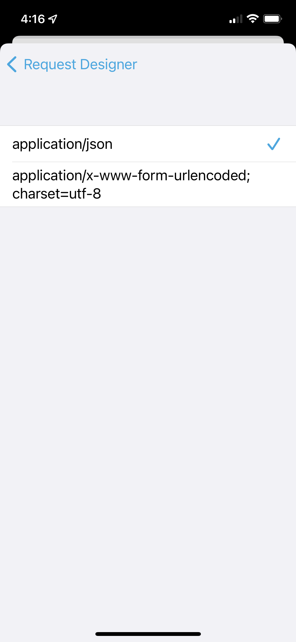

That is where I'm stuck - I cannot figure out where to paste the URL string into the locative app on my phone - found this spot but not sure if it the right place or what to do next - help....

Settings -> Global HTTP Settings

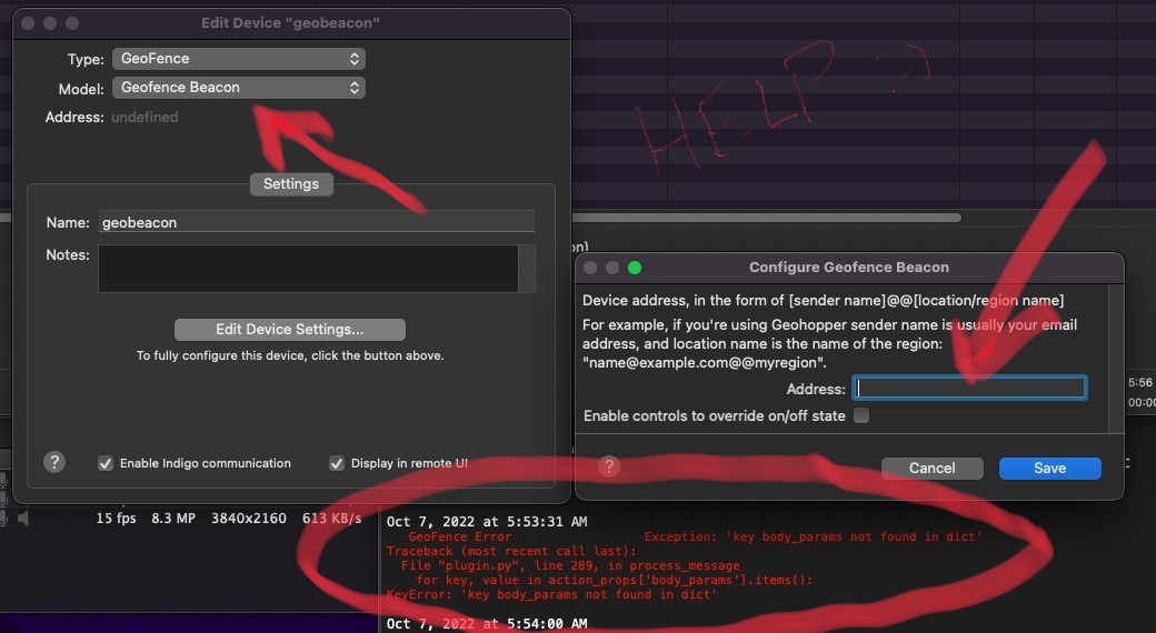

OK, great making progress - got the url entered - next figured out I had to create a device - did that and set it up but not sure what to put in the address field within Indigo beacon device settings
Picture below - also getting the error in red when I send a test message from my phone (also in picture below)
Thanks in advance for any help…

Turn on debug logging and activate the geofence. Or use the test function in Locative. You’ll see the tag that the server sends. You need the device to latch that.
I think. I can’t look at my devices until I get home.

To follow up, I got this working - I had the slider in locative set to get instead of put. - once I switched it the plug-in created a device by itself - tested it out by leaving and it works great. Thanks for the plug-in….
