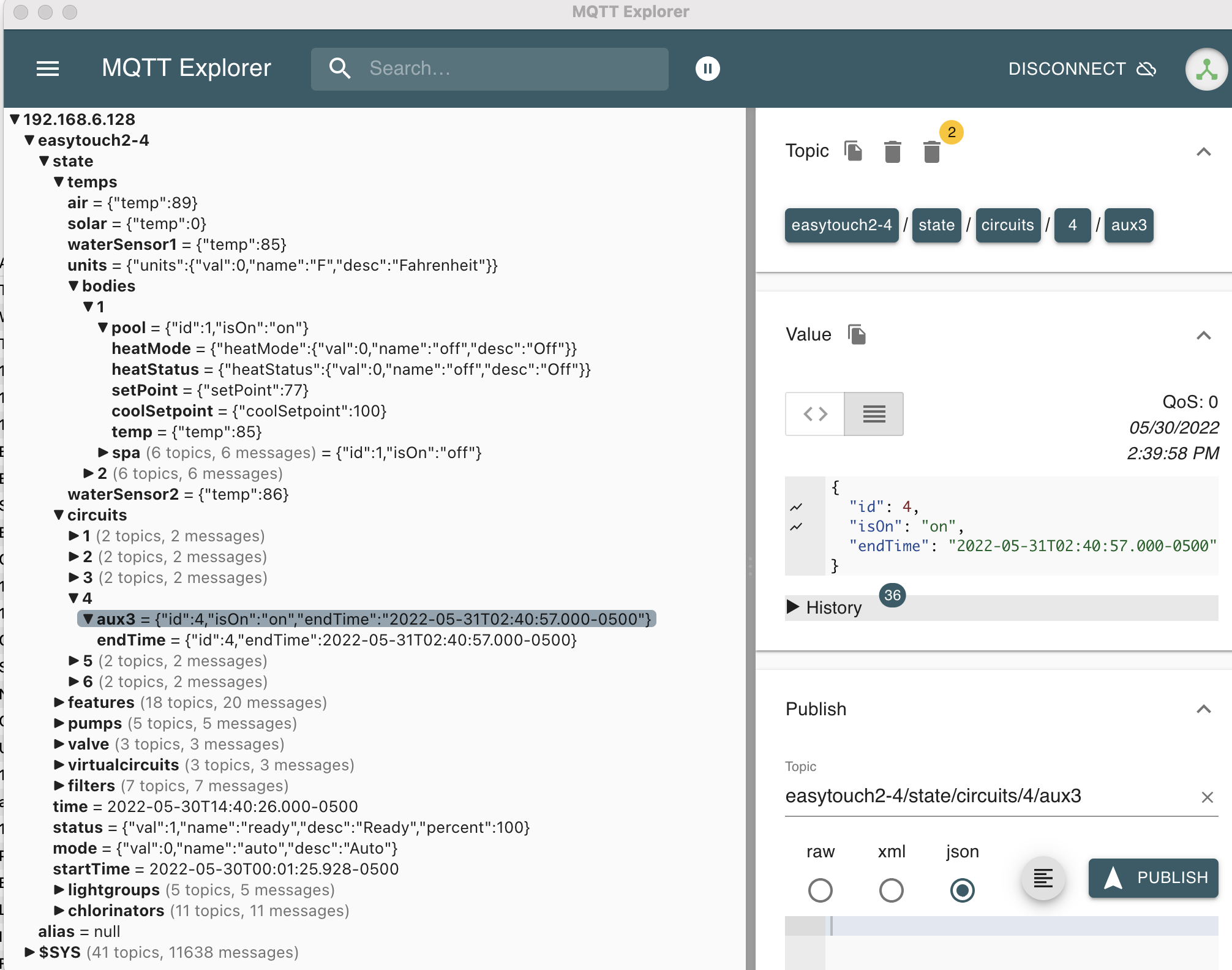

jltnol wrote:I've read the Wiki several times, but my problem is I'm trying to compare what I guess is some kind of terminal output in the examples, and what I'm looking at in MQTT Explorer, and just can't make any meaningful comparisons to try to figure out what needs to go where in my Shims device.
You're going to have to disabuse yourself of this notion. There is no "Terminal Output" in the wiki. The wiki makes no assumptions about how you're looking at the MQTT data. It could be a GUI app like MQTT Explorer, or is could be a command line tool in a Terminal, or you could be looking at the debug output of the MQTT Connector plugin in the Indigo log. There are two parts to an MQTT message - the Topic and the Payload. Whenever I discuss this in the wiki or here on the forums, I always do with the topic as a plain text string. Payload is usually a string as well, either a simple string (raw), or formatted as JSON.
As you stated, the Topic of interest is:
easytouch2-4/state/circuits/4/aux3
The Payload for this topic is:
{"id":4,"isOn":"on","endTime":"2022-05-31T01:52:12:00-0500"}
Sometimes I'll use a shorthand like:
easytouch2-4/state/circuits/4/aux3 --> {"id":4,"isOn":"on","endTime":"2022-05-31T01:52:12:00-0500"}
I prefer to reformat that like you see in the lower right corner of the MQTT Explorer window:
    "id":4,
    "isOn":"on",
This is a dict (dictionary) in JSON. It consists of a set of key/value pairs. So for this topic, the key that's of interest is the "isOn" key, which currently has a value of "on".
So just from that description, you should be able to see what you did wrong in the Shim. Your state key is "isOn" and your On value is "on".
I will say that I think whoever designed this topic scheme did a very poor job. Like why is the "bodies" topic a sub-topic of "temps"? And why does the circuits topic have numbered subtopics, each of which as a different name topic (which doesn't really match the number topic). Then there's an "id" field in the payload which DOES match the number topic. Screwy.
Oh, for your "time" device, there really is no appropriate device type because that payload can't be converted to anything useful for Indigo. So I didn't make a device to match. Perhaps that was an oversight on my part.
Last thing for now - when I'm testing things like this, I don't bother with an actual physical device. I use MQTT Connector plugin actions to publish a message that matches what I would get from the device, both topic and payload, then I just Execute the action group to test my triggers or shims. Like:

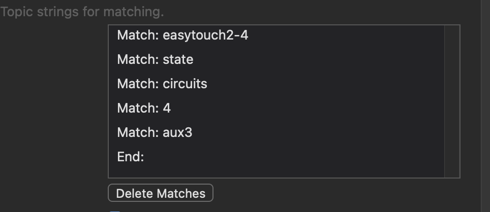

Poorly designed MQTT messages, IMO. The fix is to change your trigger to something like this, which would prevent it from triggering on the topic with the extra "endTime" on the end.
