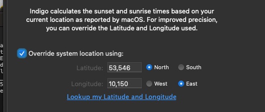

Re: Connected Drive Plugin for Indigo 2022.1
OK, that's failing while trying to calculate the distance the vehicle is from "home" (where Indigo server is).
Does Indigo know where it is? Is there a valid latitude/longitude in the Indigo Preferences "Sunset & Sunrise" panel?
Is the vehicle reporting it's location as expected? Do the plugin menu "Write Vehicle Data to Log" command and look at the end of that data. Is the data in the "vehicle_location" dict correct?
Also, what kind of engine does this vehicle have? Fuel? Hybrid?
Bildhauer
Posts: 160
Joined: Mon Sep 30, 2019 2:10 pm
Location: 22113 Oststeinbek (near Hamburg), Germany
Post by Bildhauer »
Yes, indigo knows where it is (see screenshot). My Car is a BMW 640d xDrive Convertable.
