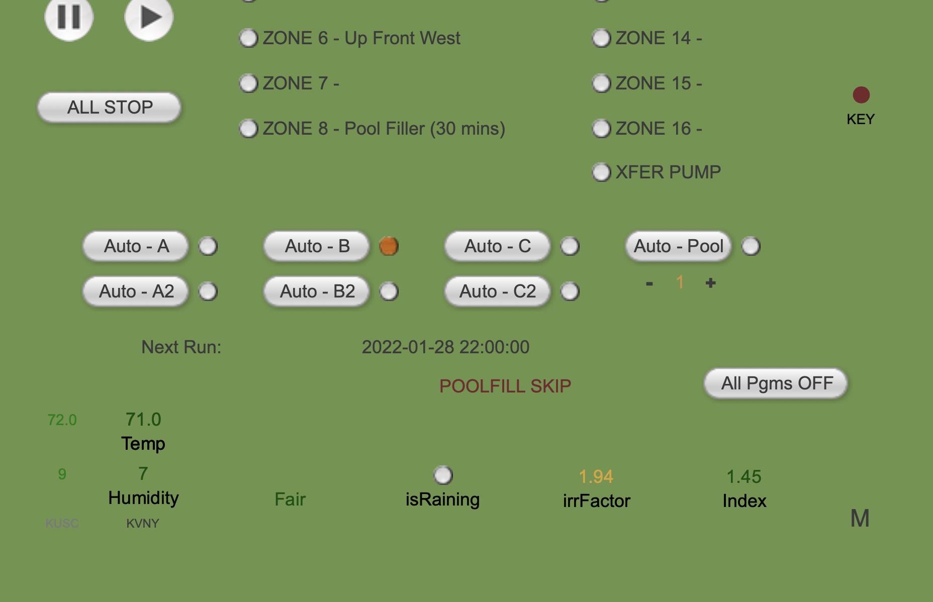

added few more lines to indicate selected station. now have the system select among two or three nearby stations whichever is latest update, then displays which one is selected for calculations (currently KVNY) and a nearby one for ref (currently KUSC). feel more secure than relying on one station.. esp given how bloody unreliable they seem to be now.
thanks for help jay.

Jan 29, 2022 at 11:53:40 AM
Action Group weather/update vars
Irrigation: KBUR Time Since Update: 1 day, 11:23:33.306442
Irrigation: KBUR Last Obs: Sat, 29 Jan 2022 10:51:00 -0800
Here's the script lines that log the obs string:
cntobsdate = wthrStation.states['observationDate']
#timeDeltaObs = datetime.now() - str(cntobsdate)
indigo.server.log("KBUR Last Obs: "+ str(cntobsdate), type="Irrigation:")
This is the latest and last METAR from this station according to NOAA. It's so old it does not show up on aggregated current obs tables.
It shows last obs at 0753Z on the 28th, which is almost midnight on the 27th here, as expected by the last comm data in the plugin. So.. what gives?KBUR 280753Z 02003KT 10SM CLR 10/M06 A3022 RMK AO2 SLP224 T01001056 402220056 $
Thx!
OH. Such a blunder.
Sorry guys. I realized just now that my var is set to the current one in the script, which at this point would be VNY.. so that explains the issue. So sorry for the panic. LOL
