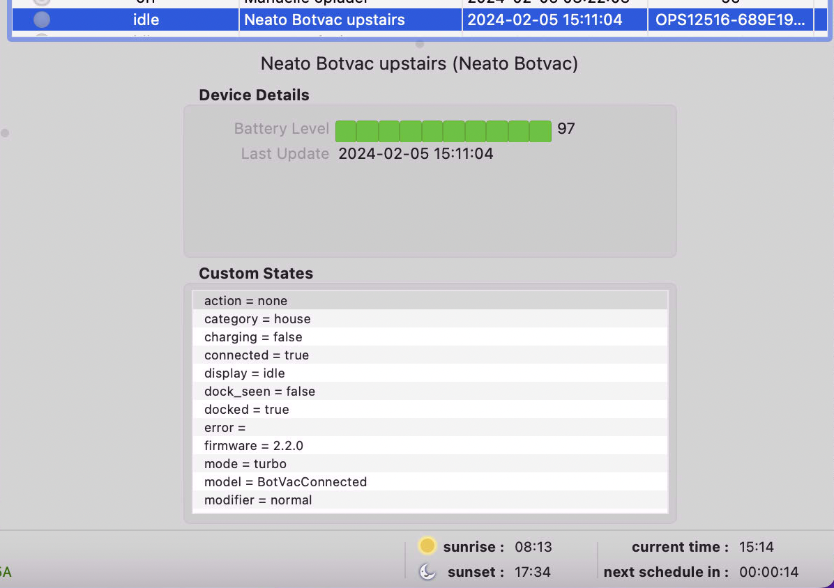

Made a new Indigo Neato Device, called Neato Botvac upstairs
The strange thing is that with an action from an Action Group, the log says:
Neato Botvac "new device" start house cleaning
Neato Botvac "new device" request status
Neato Botvac Debug "new device" available commands: {'start': True, 'stop': False, 'pause': False, 'resume': False, 'goToBase': False}
Neato Botvac Debug "new device" status update complete
I wonder why it says "new device"
Never saw that.
But there seems to be a connection because the battery status is ok and there is custom state info.
Screenshot 2024-02-05 at 15.14.46.png (496.47 KiB) Viewed 1697 times
McJohn
