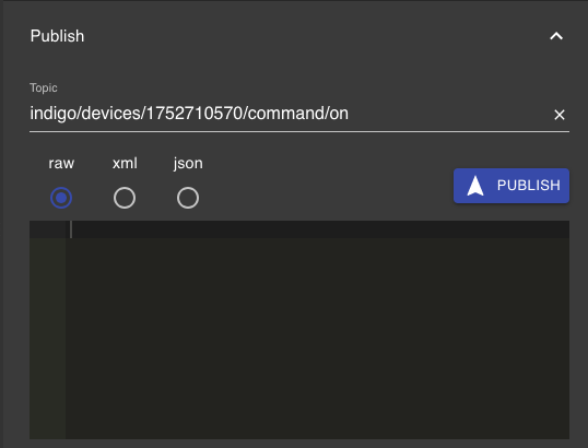

If I subscribe to
indigo/devices/1752710570/command/on
indigo/devices/1752710570/command/off
And I publish just indigo/devices/1752710570/command/on
without any payload the light goes on and off.

Re: MQTT comunication between Indigo and Home assistant
Change:
    command_topic: "indigo/devices/1752710570/command"
to
    command_topic: "indigo/devices/1752710570/command/set"
Per the available commands listed here: viewtopic.php?f=316&t=23764

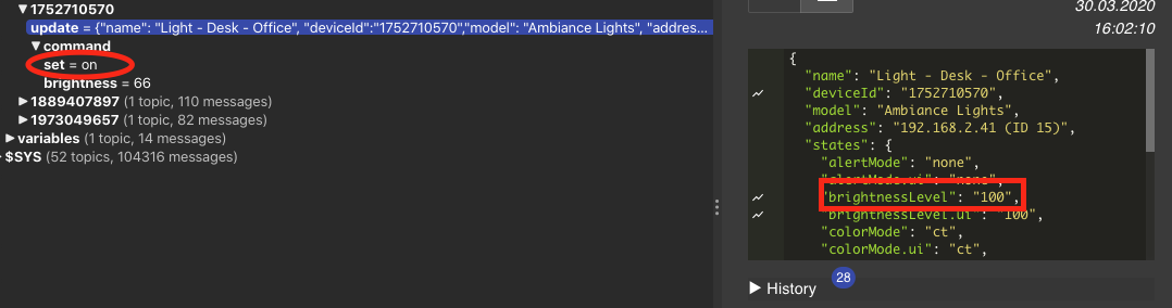

The only thing that is a bit strange now is that if I set the light to 50%, turn it off, then toggle it on, it will go to 100%. Not sure where this behaviour is configured? But I have tried with and without
on_command_type: brightness
https://www.home-assistant.io/integrati ... mmand_type
Could this be related to how data is processed when received on the Indigo side? I can observe that when I set the light to 50%, then off, and then toggle, it will only be transmitted a mqtt on, not an updated brightness.
Skjermbilde 2020-03-30 kl. 16.02.34.png (71.51 KiB) Viewed 2836 times
Håvard
I'll need to see the Indigo log for both methods of controlling the light. Basically, I need to see what commands are being sent to the plugin controlling that light, using both control methods. You might need to put the light's plugin in debug logging mode.
